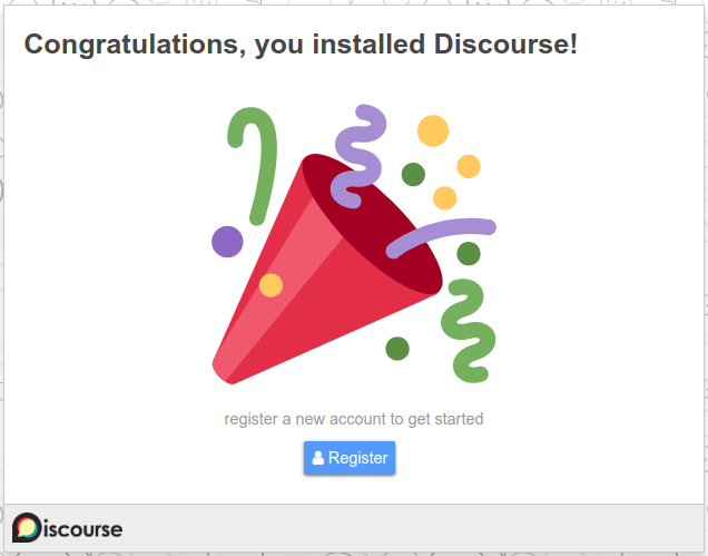

But, the tcpdump appears to have shed the necessary light! And now I see the typo in /etc/network/interfaces (perfectly replicated on all three servers) that was the root of the problem.
Hooray for simple (that I still don’t quite understand) networking errors!
And from there I found that I do know how to get pups to bind to a single IP.
And soon, a few people can use a server that if it catches on fire will be down until I wake up and look at my phone.
Thanks, Matt. My day is saved.
