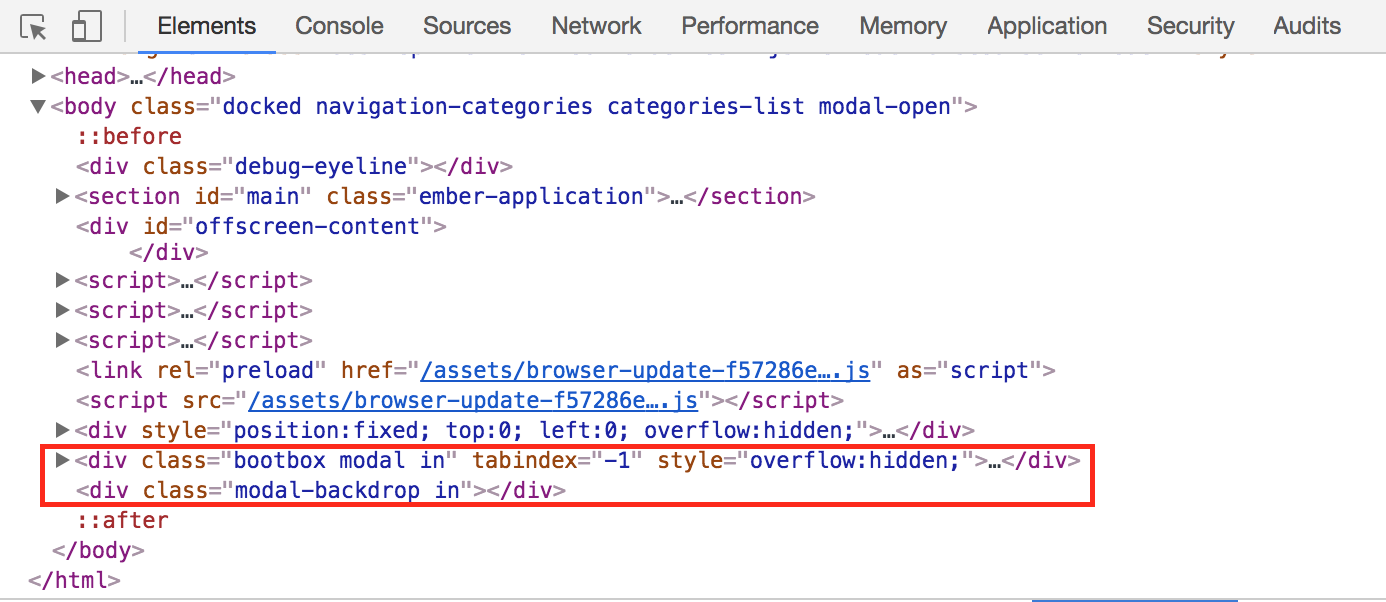

  4. If you receive the popup modal, use the Developer console to delete the modal
