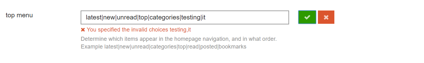

Invalid items can be added to the top_menu setting
It is possible to add invalid menu items to the top_menu setting. If an invalid item is the first item in the SiteSetting.top_menu list, the site will broken in a way that can’t be fixed through the UI.
I’m not sure if there’s ever a reason to be able to add custom menu items to the top_menu list.

We need to hide this setting entirely, it has caused way too many problems.
Couldn’t we just restrict what can be added to the top_menu to a list of valid items?
Exactly what problems has it given people, I wouldn’t think someone would intentionally place invalid items on this menu, knowing that it would break their site, it says in the description of what to place. I still have this setting on my community, I have no problems with it.
What can go wrong is that a non-existent page can be set as the Discourse homepage. In the example I gave above, Discourse would be trying to find /foobar for the site’s homepage. It wouldn’t be possible to remove foobar from the top menu items, because on refreshing the settings page, ‘foobar’ would not be displayed as a top menu item, but foobar would still be stored internally by Discourse as the first item in the top menu list.
We could and we should, we also should have app safe guards that ensure that this kind of breakage is not possible.

  1. Very oddly, we don’t appear to have a proper validator for site settings that ensures a string must match a regex. We have one for string must include regex which is very different. I need this cause the regex will be ^(latest|categories|top) combined with (2), allowing unread and others to be home page causes support issues, they can do that in a plugin.
  2. We don’t appear to have a setting on “list” that ensures you can not add “free form” text to the selections, this is really bad cause post_menu also would use it so you don’t add bogus stuff to post_menu.
  3. The help text is not great
I agree we have suffered here with this setting and post_menu to a degree and want to at least remove this suffering.

We have an extra allow_any attribute for site setting (default is true). If allow_any is set to false on a list, the choices are restricted so they always match the list.
So for this case, top_menu is now restricted to any combination of:
choices:
     - latest
     - new
     - unread
     - top
     - categories
     - read
     - posted
     - bookmarks
But… the control used in the UX is now an ugly text box. Since this is a site setting we can live with this, but it is visually somewhat ugly.
That said, you can no longer shoot yourself in foot, which is great.
