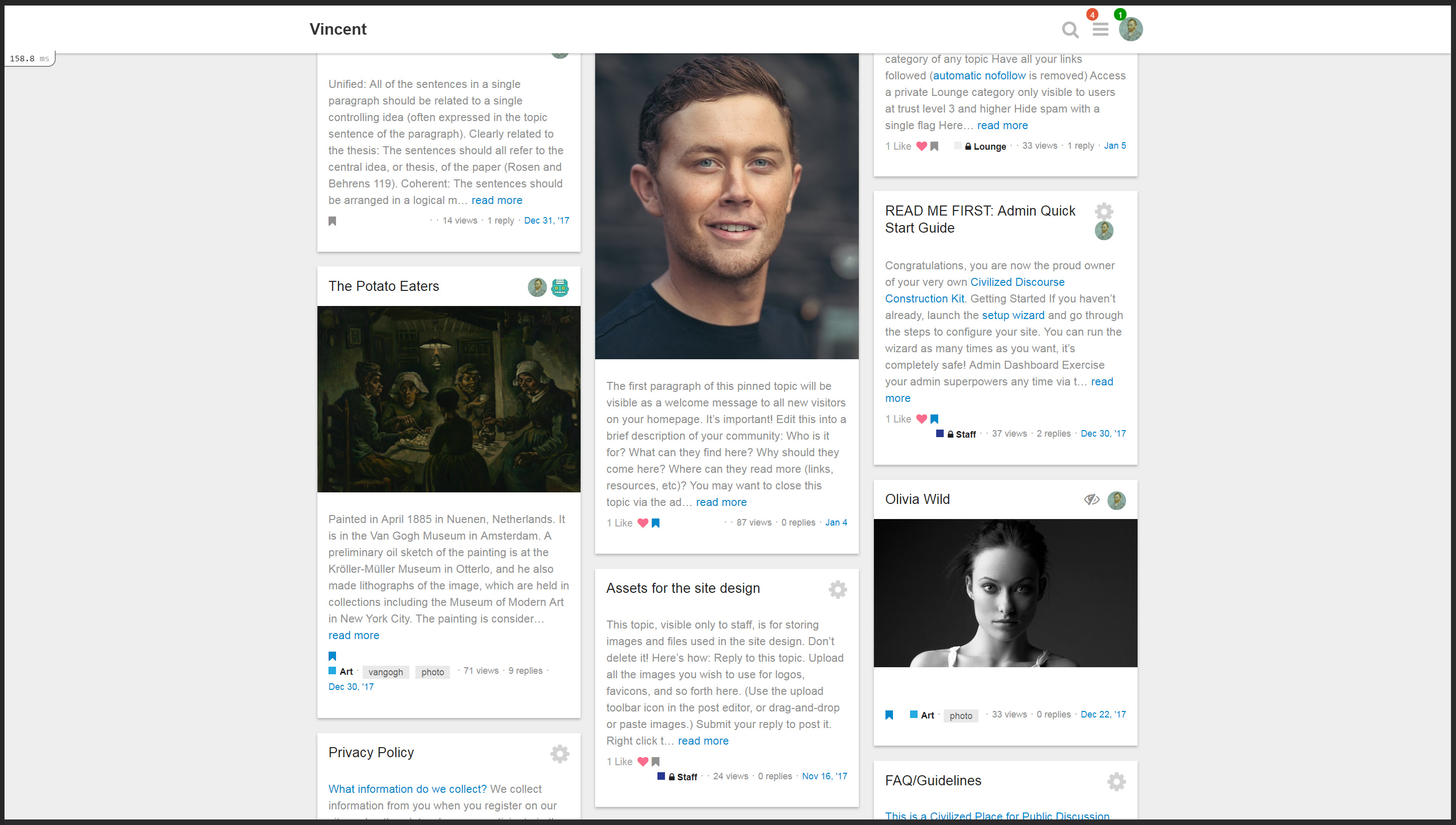

I’m trying to use masonry in combination with the topic list previews plugin to create a grid topic list like so:
When new items are added to a masonry grid or the topic-list in this case the current items need to be “reshuffled” and resized in some sense so that everything fits.
Masonry handles that with a native function or .layout() which recalculates the grid and arranges the items when called.
In order to make masonry aware of new items or topics being added to the topic list, I would like to trigger .layout() when this is clicked:
So here’s the question.
Is there a native Discourse event that fires when the the link to reload the topic list is clicked that I can bind masonry to?

And here’s the result:
https://giant.gfycat.com/FeistyFormalBoa.webm
Thank you so much :heart:

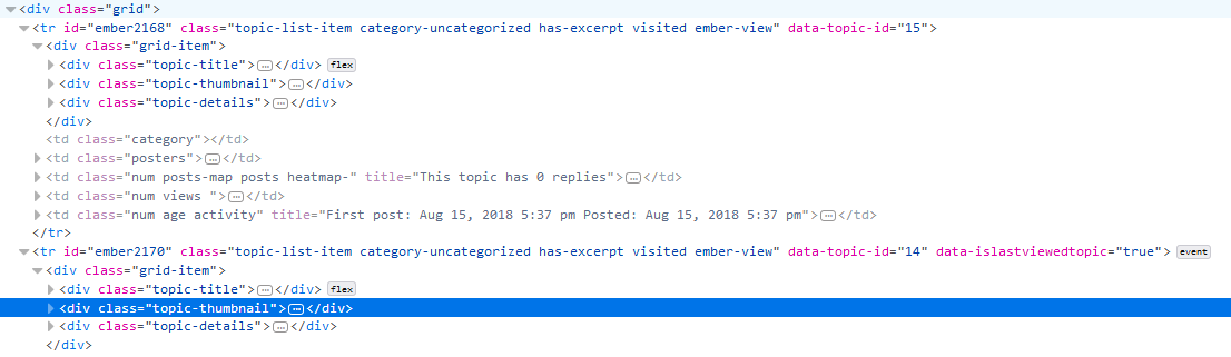

OK I’ve reached a bit of an impasse:
I’ve edited both
  • topic-list.hbs: (added to TLP plug-in so I can change tbody to div)
{{#if socialStyle}}
<div class='grid'>
  {{#each filteredTopics as |topic|}}
    {{topic-list-item topic=topic
                      bulkSelectEnabled=bulkSelectEnabled
and:
  • topic-list-item.raw.hbs (taken from TLP plug-in but edited)
{{#if socialStyle}}
<div class='grid-item'>
    {{raw "list/topic-list-title" topic=topic socialStyle=socialStyle showTopicPostBadges=showTopicPostBadges}}
    {{#if showThumbnail}}
      {{raw "list/topic-thumbnail" topic=topic thumbnails=thumbnails category=category}}
      {{/if}}
But I still end up with a <tr> tag being added between them and can’t see where it’s being generated?:
Could this be being added by the javascript in topic-list-item.js.es6? Most definitely.
Attempting to overwrite with this in the initialiser:
api.modifyClass('component:topic-list-item', {
  tagName: 'div'
So I now have this working …
