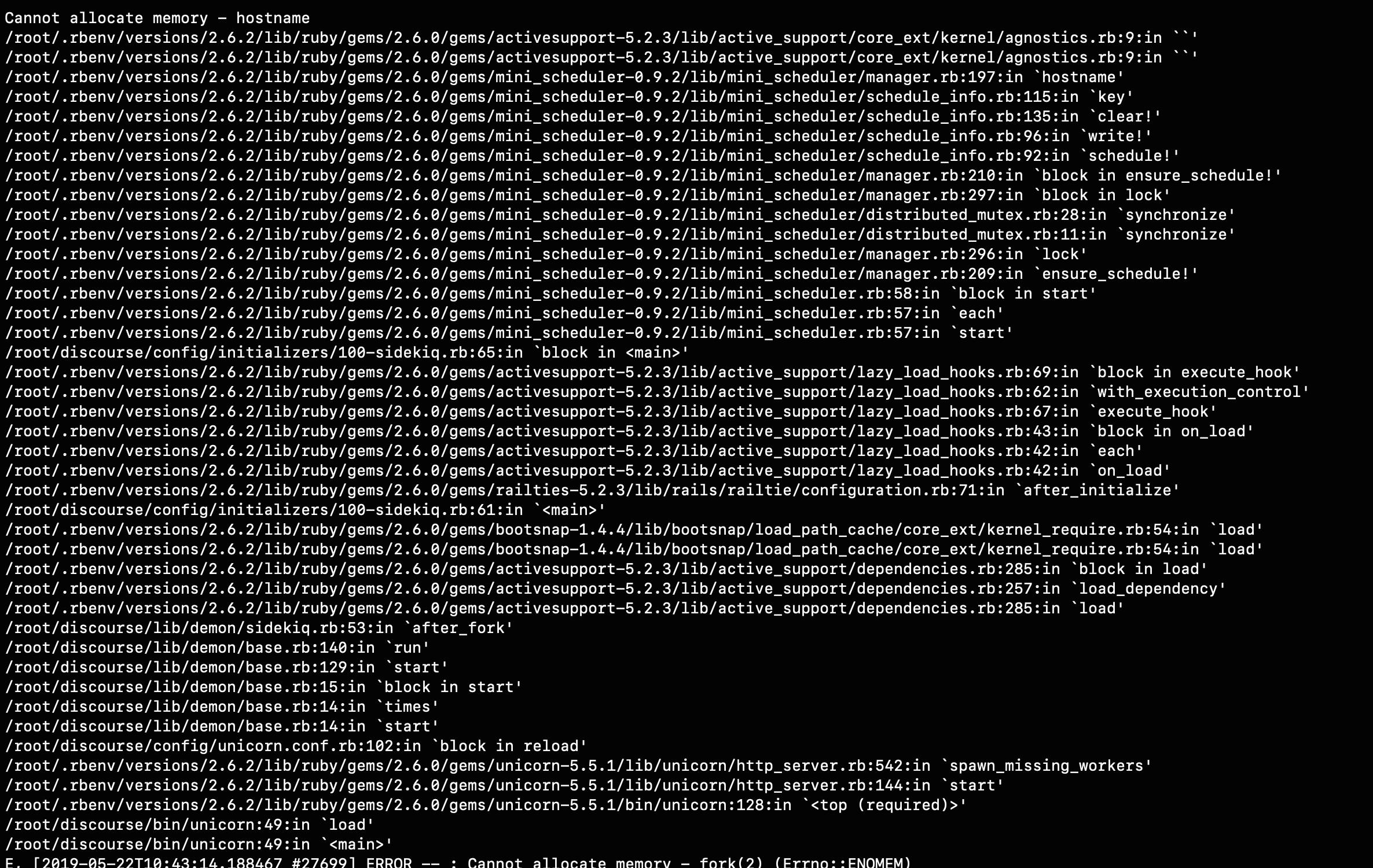

Discourse を Ubuntu サーバーにインストールしようとしています。すべてのコマンドは成功するのですが、以下のコマンドでフリーズしてしまいます:bundle exec rake autospec。前のコマンドをスキップして bundle exec rails server を実行すると動作しますが、ポート 3000 のポータルにアクセスできません。

This is the issue i guess, But I am not sure how to resolve this. Anyone??

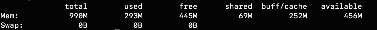

How much ram do you have? What does
 free -h
Say?
What are the minimum system requirements for discourse setup?
1GB of RAM with SWAP, I think you need at least 2GB of SWAP.
That’s true for a docker install, but a development install will likely need more than that.
Do you need a development setup?
You might try Install Discourse for development using Docker, but if you want to do development you’ll likely want at least 4gb.
I’ve run development environments off the DO $5 droplet and they work just fine. Not fast but not unbearable either. CPU speed is probably more important.
@Vishal_Kaushik do you have anything else running on this server? And is it a cloud server or something local?
I asked my devops guy to create a new instance with better specs and it worked fine on it. Thank you all for the help.
