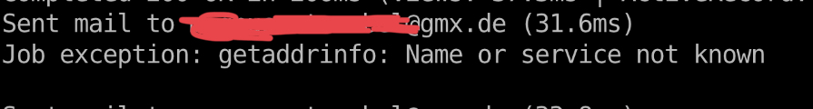

So, I have installed Discourse and I am having issues with the email.
I‘m using SparkPost and followed this guide.
Now I used the troubleshoot guide, and at the part where you‘re supposed to check the discourse logs is where I‘m at right now. I looked at them and found this:
Now, I understand this as an email was sent but something is not known or failed?
Could someone help me?
Stephen
(Stephen)
2019 年 4 月 25 日午後 10:17
Where did you install Discourse?
Is DNS working correctly? Can you resolve the mail server address from the server?

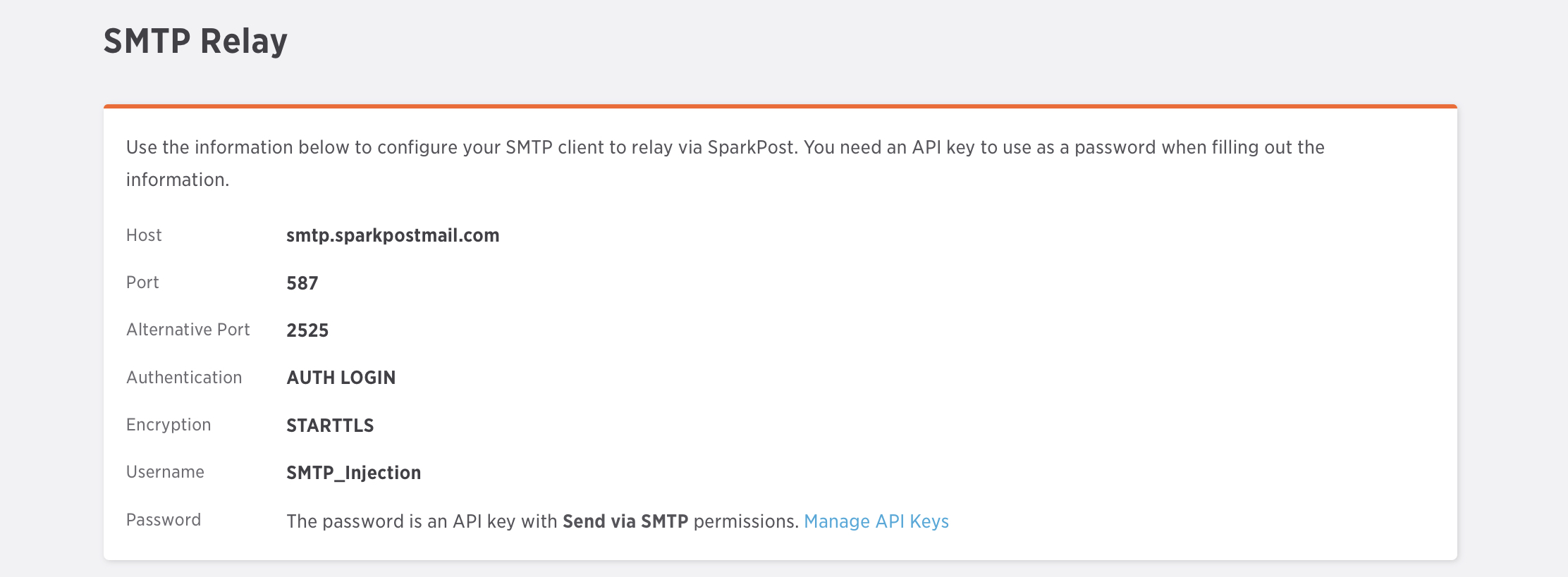

2019 年 4 月 25 日午後 10:31
The address of the SMTP server, which is a DNS name, not the SMTP address sparkpost is using, which would be in the format user@realm.com
MST2
2019 年 4 月 25 日午後 10:35
7
Anything here?
(Sorry if this is hard..)

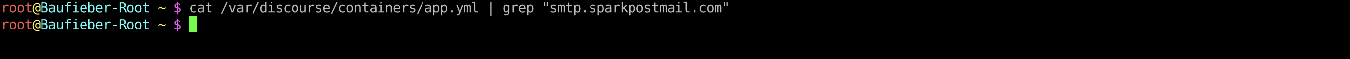

2019 年 4 月 25 日午後 10:37
8
So
SSH into your server and do this:
ping smtp.sparkpostmail.com
Also, if you:
cat /var/discourse/containers/app.yml | grep "smtp.sparkpostmail.com"
What’s the response?
If you don’t get back a line like this:
DISCOURSE_SMTP_ADDRESS: smtp.sparkpostmail.com
It’s very likely that you typo’d the address during discourse-setup, which would explain why your server can’t resolve it. You can re-run discourse-setup or edit the app.yml to correct it.
MST2
2019 年 4 月 25 日午後 10:43
9
Since there is no response from this:
It means this:
Right?

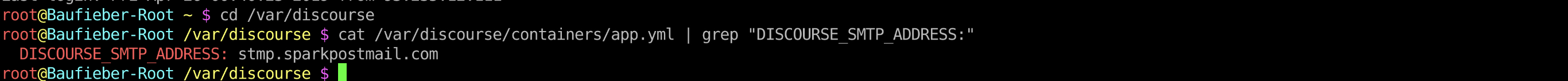

2019 年 4 月 25 日午後 10:46
10
If you’re SSH’d into the Discourse server and Discourse is installed in that path then yes.
You can check what’s in that line by doing this:
cat /var/discourse/containers/app.yml | grep "DISCOURSE_SMTP_ADDRESS:"
It should return something, if it doesn’t then there’s something more fundamental that’s awry with your setup.
MST2
2019 年 4 月 25 日午後 10:48
12
Oh I see it now, I wrote stmp even though it‘s smtp.
