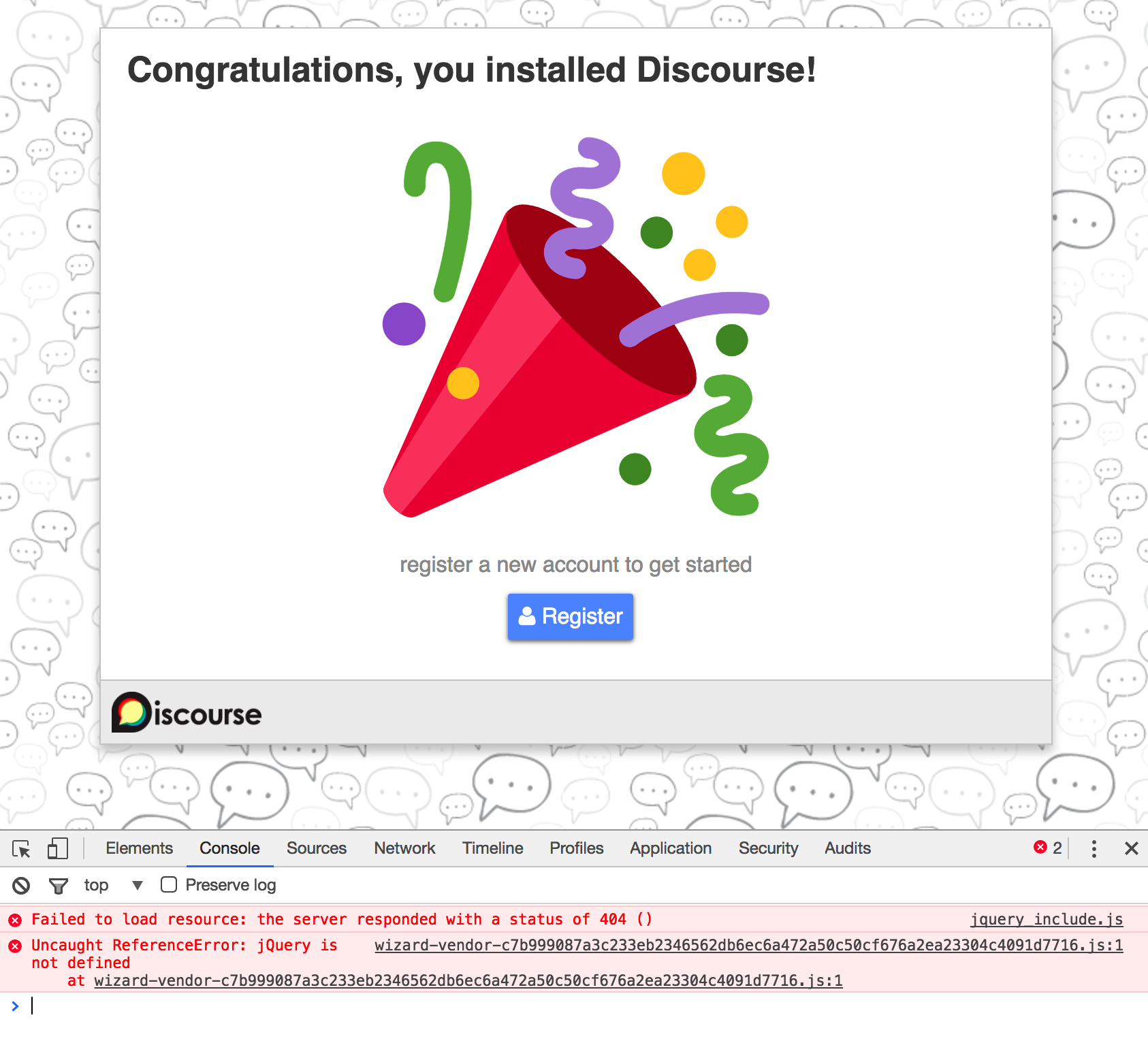

Jquery errors in the setup wizard
The forum I’m trying to start now won’t send the initial email. it’s logging:
Uncaught ReferenceError: jQuery is not defined
    at wizard-vendor-c7b999087a3c233eb2346562db6ec6a472a50c50cf676a2ea23304c4091d7716.js:1
Is this because of the failed first run attempt to set up https? If so then do we need two topics for the same issue? Also if so, just rebuild, or rebuild without https?

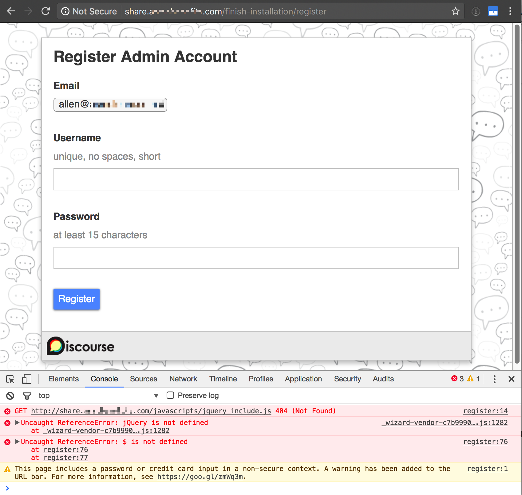

I have the same issue
Incorrect. I just performed a 100% by the book, official install guide, new install on Digital Ocean and I got the admin mail just fine.
So you seem to have a garden variety “didn’t set up email correctly” problem, and should refer to our existing guides.

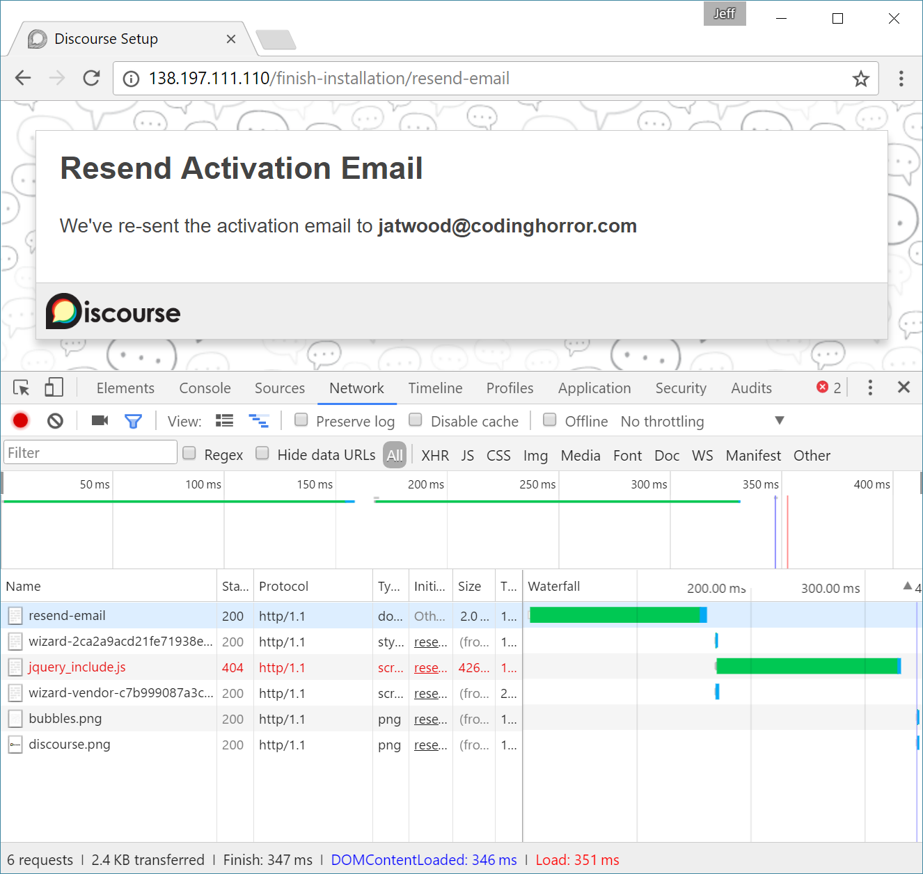

The jQuery error here should probably be fixed @eviltrout, is this a result of the double minification fix?
It was a regression there. Oddly it didn’t seem to break anything but I’ve fixed it here:
https://github.com/discourse/discourse/commit/2fedf1c66800b0249fbf40e741c304d3db4cdac8
