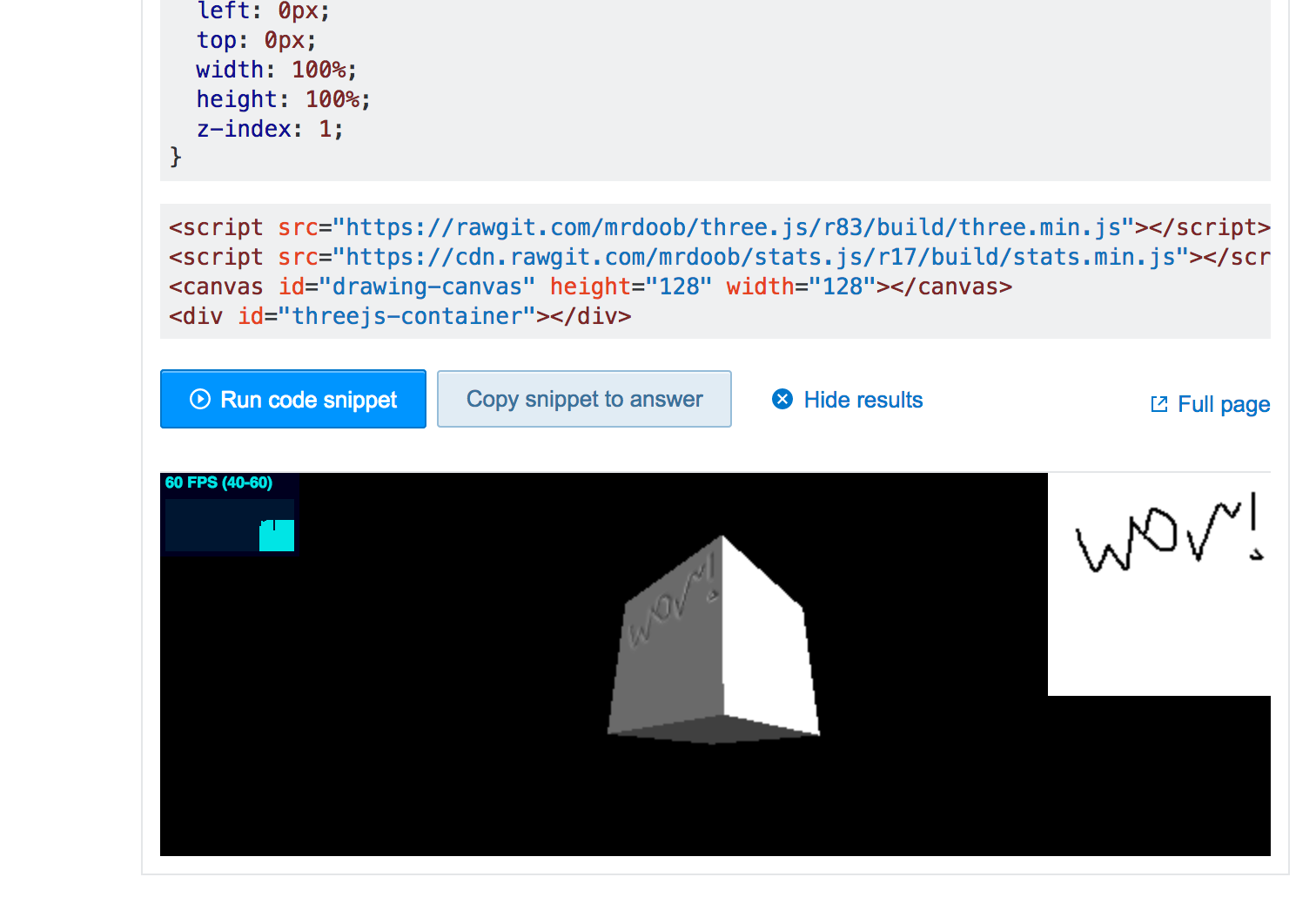

Hello! Just getting started with our community at https://discourse.threejs.org! I wanted to know the right tool to enable us to embed jsfiddles or similar into posts? What I’d essentially like to do is something like is shown in the answer to this stackoverflow question. Here, a working solution is offered right in the post. Is something like this possible?
