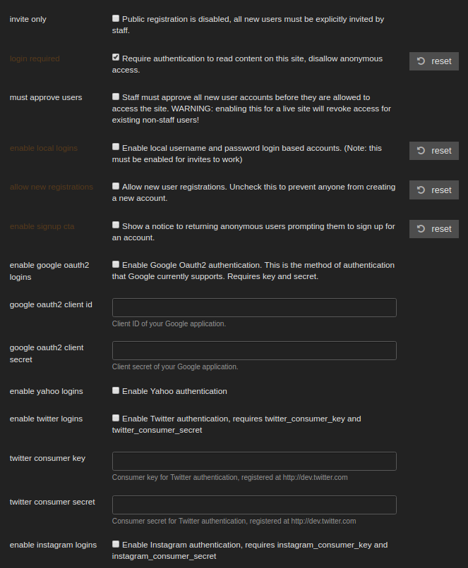

Ok, this is the last time I’m repeating this.
If you have login_required set to true AND OAuth2 is the only login strategy (disable local_logins and social logins), the user should be prompted to login without clicking on the button. Many people use this, and it works fine.
