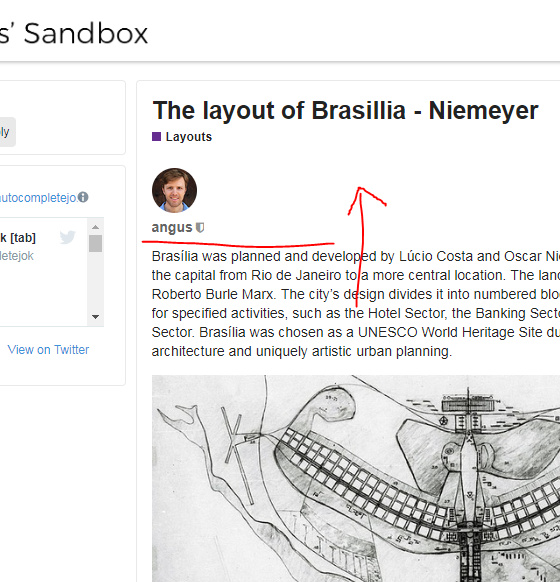

After the latest update I think css is broken. Can you check
Do you still have that problem if you use safe mode or see it on other sites? Can you share your url?
Such as on our site also on the producer’s site.
Edit :
.main-content.topic.has-sidebars .topic-body {
    width: auto;
    padding: 0;
    border-top: none;
    z-index: initial;
    float: none;
@nothing Thanks :+1: Fixed.
