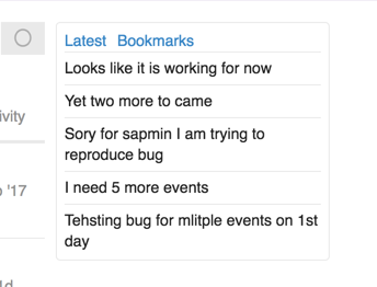

I’ve made some updates to the layouts plugin and the layouts-topic-list that will fix the issue you’re seeing and also allow you to show a bookmark list.
The layouts-topic-list widget is now a general purpose topic list widget that lets you display multiple topic lists, set using the site setting layouts topic lists.
UI
Settings
You can see it in action on my sandbox here: https://discourse.angusmcleod.com.au/c/layouts

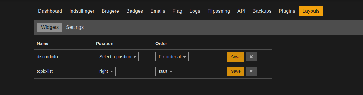

Brilliant - thanks! But, i’ve a problem here..
The topic-list is enabled:
A few is added:
And layouts sidebar is enabled at the frontpage:
But nothing shows up:
Am i missing something, or could this be a bug? The topic list was disabled in the Layout-settings for a short amount of time. (layouts enabled is also ticked, ofc.)

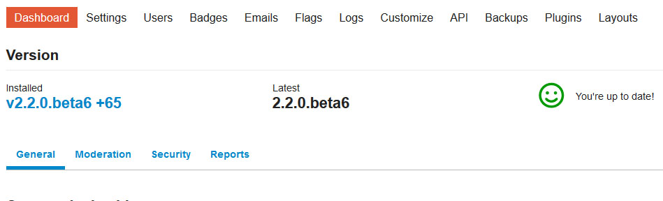

@haffax7 Are you on the latest versions of the Custom Layouts and Layouts Topic List Plugins? Check /admin/upgrade

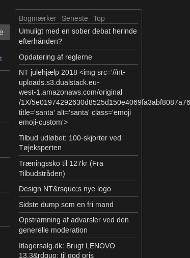

Guess overflow:hidden will be a good idea, and maybe consider to remove all HTML-elements.
Example with both things present:
Handling of fx ' and other things could also be a good idea :slight_smile:
BUT, with that said:
Thanks for the fixes! :slight_smile:

Enter settings:
For the right sidebar, you need to define where it’s enabled, fx. latest or enabled it globally (2). You’ll also need to enable layouts overall. (1)
++ each layout/widget should have a position defined within the custom “Layouts”-tab in the Admin-panel.
This was a fast one.. Hope it make a bit of sense :slight_smile:
