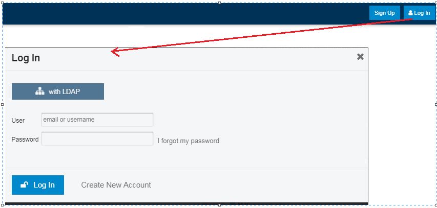

Hi,
I can directly access with “https://discourse-xxx.xxx/auth/ldap” for LDAP login, but I don’t see LDAP pop up after clicking on login button ( as shown in below screen shot).
Can any one please let me know if I will need to modify the Login form in the initial Discourse page to include an extra button that can allow me to redirect to “https://discourse-xxx.xx/auth/ldap”.

Did you disable local logins like shown here? This is what we use in a setup.
Hi, Thanks very much for the response.
When i disable local login (unchecked " enable local logins" option) and clicking on login button, and I got below blank pop up.
Did you enable the LDAP plugin and did the basic configuration?

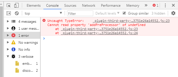

Browser dev console has some errors or hints on the matter?
Hi, Thank you for the hint.
I checked by cliking F12 in google chrome, and it has below errors in home page:
Uncaught TypeError: Cannot read property ‘addPreProcessor’ of undefined
at _plugin-third-party-bbf5e2e3e7e7a22c7391a8d01a610ce18dd03367259d13426ed3751e26a14552.js:23
at _plugin-third-party-bbf5e2e3e7e7a22c7391a8d01a610ce18dd03367259d13426ed3751e26a14552.js:24

So it looks like you are using a third-party plugin that is broken. And it’s not the LDAP one.
Can you try safe-mode ?

We don’t have that in our setup. The JS error should be solved, that’s probably causing the page to not render properly.

I’d say you disable the jira and abbreviation plugins one by one and try to eliminate the error (each line removal with an app rebuild). Those plugins look dated, last commit was 2016. Not sure if they’re still compatible with Discourse, nor if they’re supported.
The abbreviation and jira onebox plugins for example were moved to #plugin:broken-plugin in 2016.
