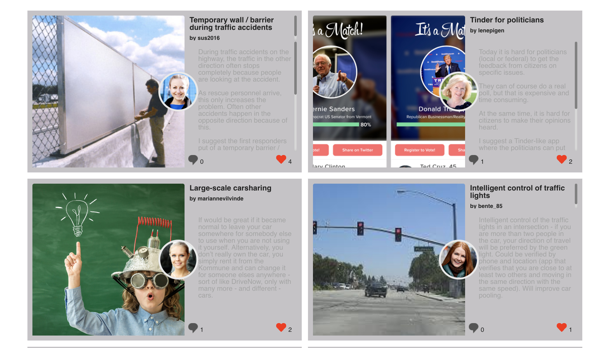

I have customized the discourse platform for a client
What i’m trying to is to only change the color of the heart icon, if the current user have liked that post.
The problem is, that the heart icons, changes color for all the users.

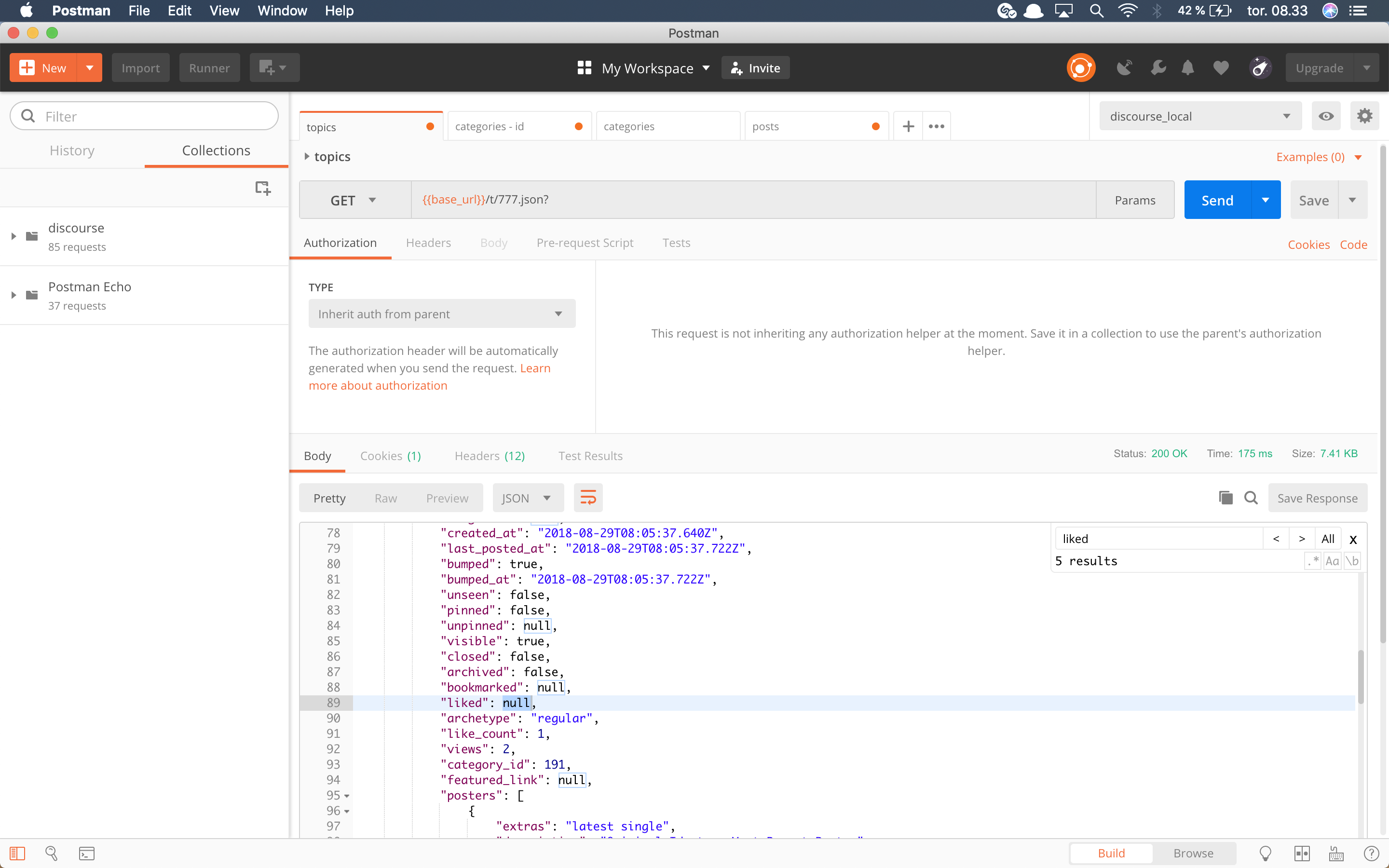

Okay I tested it in the postman
As you can see the like_count is 1.
Why is my liked attribute null?

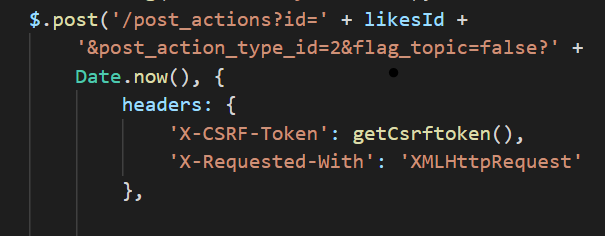

In my system the property ‘liked’ that you are referring to is going from null to false upon liking. The id that is passed as ‘likesId’ on the picture below is the id of the topic I am trying to like.
Do you have any explanation for this behaviour, or possibly a solution, so that the property returns true as intended, upon posting a like? It seems to be hindered by something.

I may not be understanding, but are you trying to increment a post action (i.e. a like) by passing in a topic id instead of a post id? AFAIK, there is no such thing as a topic action.
I realise there is no such thing as a topic action, but in my case I need something equivelant to topic_action, otherwise, how does it make sense to like anything but a post?
Well, Likes can be given only to posts. But Likes can be associated with other data. eg.

That looks like JSON for the latest topic list page. The “liked” is whether or not you liked a post in the topic. (false if you read it but didn’t Like, null if you didn’t read it while logged in). The “like_count” is the number of likes for all the posts in the topic combined.
Depending on what kind of information you want, there may not be what you need in that JSON alone. More intricate criteria may need to run a query against more than one table. Or maybe XHR calls to other pages to get their JSON.
