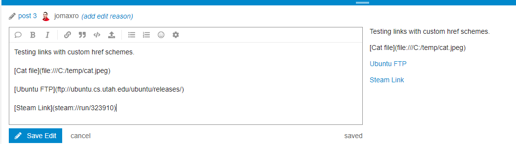

Can confirm that we did not regress completely, adding ftp or steam works. I cannot get file to work, however, though that could just mean I’m doing something wrong. Never used the file href scheme before.

No clue. As mentioned, I’ve never seen the file href before. I used 3 for my screenshot as that’s what I saw over on SO: https://stackoverflow.com/questions/12837024/href-file-doesnt-work. In any case, I tried 1 (just in case), 2 (normal), 3 (SO answer), 4, & 5 (example in OP) slashes, none worked.
