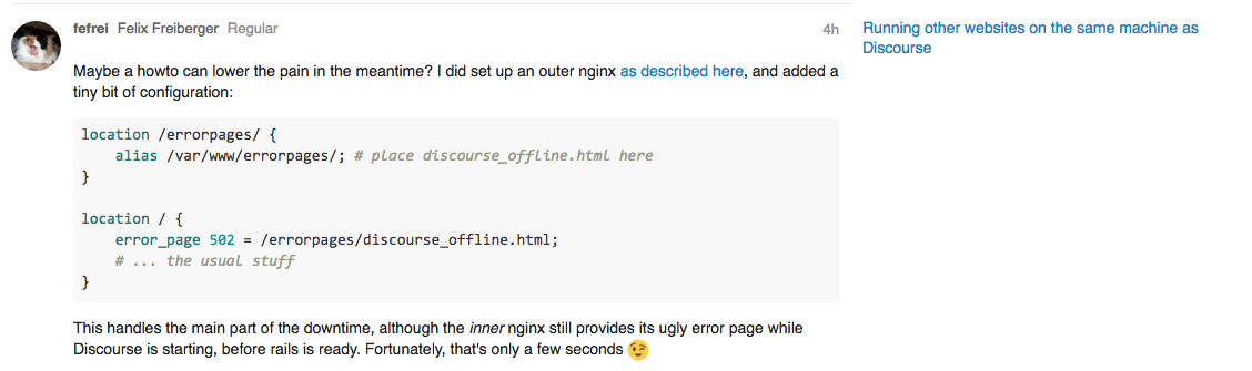

Here on meta I see that inline links to other topics are also ocassionally shown on the sidebar, like here:
However, my “inline links” link above isn’t showing either and it puzzles me. How do I link to another topic such that the link would be shown in the sidebar?
