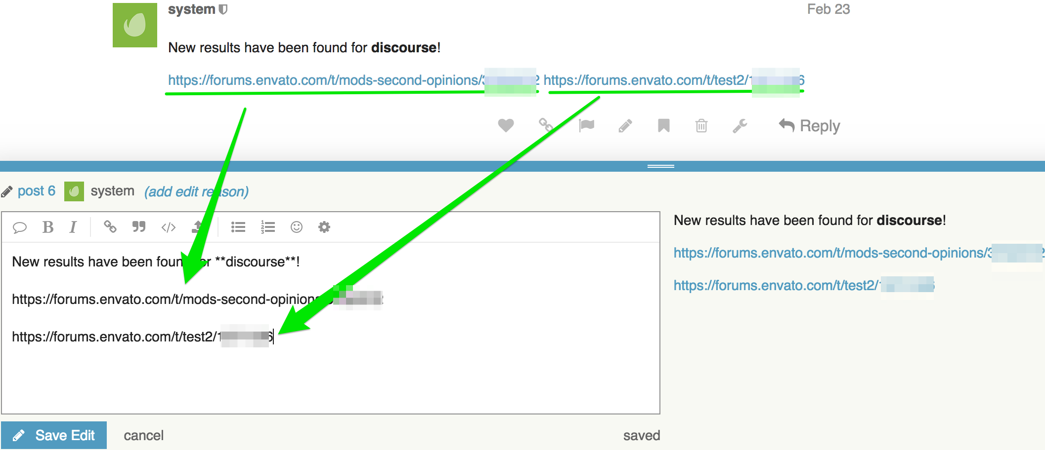

A bug impacting the saved searches plugin:
I think this is caused by links in secured categories which won’t be oneboxed. The preview pane shows the desired output, but they end up on one line in the final cooked post.
That is very odd as there are clearly linebreaks between the links.
I think I saw something similar here: https://meta.discourse.org/t/inline-onebox-not-working-with-public-topics/83641/3 I suspect this is due to my markdown.it upgrade. Going to write a test case for this.
I fixed our code that was supposed to strip empty <p> elements but was a bit too greedy
https://github.com/discourse/discourse/commit/3c8b43bb011da73507c022b0dceaa807fd718c3f
