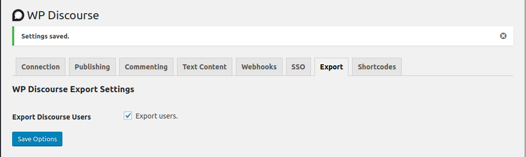

@simon I was just looking at WP Discourse plugin (1.4.7). I don’t see this option. Is this not in production yet?
No, I haven’t worked through the problem of dealing will a huge number of API calls.
