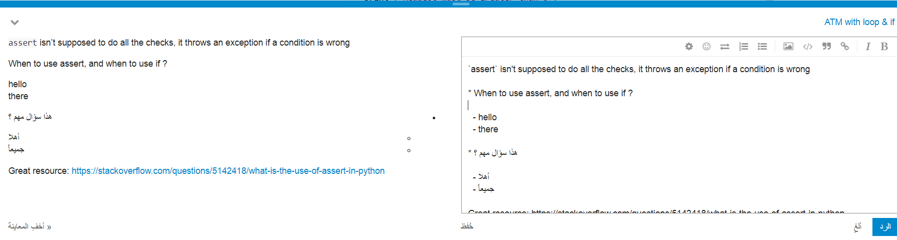

I noticed that if I am using an RTL language in discourse, like Arabic or Hebrew, the LTR language markdown styles won’t show properly, sample:

Yes, I can reproduce that issue with lists. The markdown is being parsed correctly, but the padding on the <ul> element is being added based on the user’s locale, not on the language of the text. This can be fixed. A temporary workaround is to add this CSS to the site’s theme.
ul[dir="ltr"] {
    padding-right: 0;
    padding-left: 40px;
ul[dir="rtl"] {
    padding-left: 0;
    padding-right: 40px;
Have you noticed any other issues with markdown?

The issue with the markdown I looked at here GitHub - coretabs-academy/backend-tutorials · GitHub is where there are list items with different text directions in a list. The direction of the <ul> element is set from the text in the first list item. Code blocks as a list items will work correctly, but for any other mixed text, if you want the content to be aligned correctly, you have to create two lists. There doesn’t seem to be markdown syntax for ending a list. Adding a closing </ul> element or a line of text that is outside of a list works.

If you inspect the parsed HTML with your browser, you will see that this is what it’s doing. Each HTML element has it’s dir attribute set based on the first strong rtl or ltr character in the text. Unfortunately, lists are a special case, because the outer ul or ol element sets the alignment for each of the inner li elements. If you look at the parsed li elements, you will see that the dir attribute is set based off the first strong character. For example, the html that is generated for this list:
* this is a left-to-right list with a right-to-left element
* هذه جملة تنتهي بعلامة ترقيم!
is
<ul dir="ltr">
<li dir="ltr">this is a left-to-right list with a right-to-left element</li>
<li dir="rtl">هذه جملة تنتهي بعلامة ترقيم!</li>
</ul>
The outer ul element sets the alignment for the entire list. The inner li elements have their direction set correctly, This is useful for keeping the punctuation mark in the right place. There is an issue with the list bullets when mixed text directions are used in a list. I’ll see if that can be fixed. In general, I think it would be best to avoid using lists with mixed text directions.

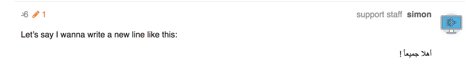

hmm… but, the paragraph tags are not rtl’ed based on the first char (please look at my previous reply)
I think it’s better if the above text is shown as
Difference is simple:
<p>Let’s say I wanna write a new line like this:</p>
<p>أهلا جميعاً !</p>
V.S:
<p dir="rtl">أهلا جميعاً !</p>
One thing to note, is that this will only work on sites that have enabled the ‘support mixed text direction’ setting. That setting is not enabled on Meta, but I can see from the screenshot in your initial post that you have been trying this on a site that does have the setting enabled.

The result looks like this:
Entering the text as Markdown also works, and is the more standard way of doing it:
أهلا جميعاً !
When using Markdown, you must include an empty line between the two lines of text to create a new paragraph.
If your text is inside of a list, it will not work as expected.
If the above Markdown is not working for you on a site that has enabled mixed text direction support, can you let us know which browser you are using?

Ah… my bad !
Actually what I tried is above (in Opera) assuming it would behave as in my forums, right here forums.coretabs.net… but as you said, it works well with that option enabled.
Thanks a lot for your fast responses and cooperation.
