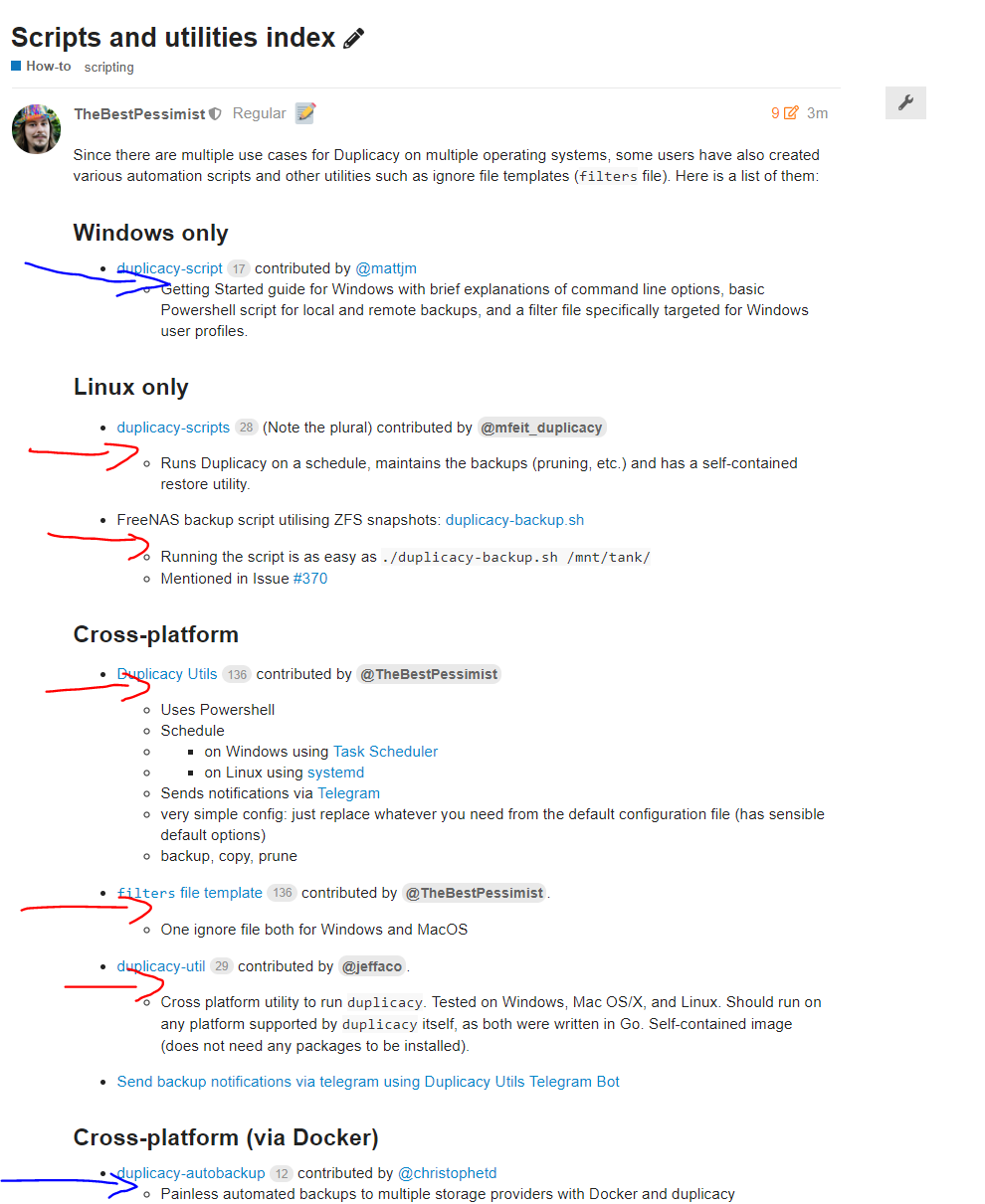

Les listes imbriquées Markdown ont un espacement vertical différent selon la profondeur des puces
For some lists (blue arrows) there is no vertical space between list indent lvl 1 and indent lvl 2, while for other lists, which are constructed the same (from what i could see at least) there is a ~0.7 of a row of vertical space.
I have tried to have the same indentation for the whole document:
- indent lvl 1, "-"  is at column 1
  - indent lvl 2, "-" is at column 3 (there are 2 spaces before the "-")
    - indent lvl 3, "-" is at column 5 (there are 2*2 spaces before the "-")
Link with the problem: Scripts and utilities index - How-to - Duplicacy Forum
Image:
And here's the copy-pasted markdown from that post

Probably loose vs. tight lists.
  • tight
  • list
vs
  • loose
  • list
You have to be consistent, either all tight or all loose. You can’t mix.

not really seeing it. You think links are the issue? You need to break this down to the absolute minimum.
Repro in a smaller comment just above yours: Markdown nested lists have different vertical padding for different bullet depths - #7 by TheBestPessimist (in #7)
Just edit my post, the last line and check the preview
:angry: That’s exactly what I said it would be. You convert it to a loose list when you add spacing like that.
I still don’t understand :frowning:
  • tight
  • tight
vs
  • loose
  • loose
You cannot have lines between the bullets, if you do, it converts everything to a loose list. Perhaps the nested nature of the lists is obscuring the issue for you, but the rule is the same no matter how nested the lists are.
Either a list is loose, or it is tight. There is no in-between state.

Ok. I see now where the problem was. The loose ones are applied even though i have nested inbetween, right?
Sorry for the brain fart!
