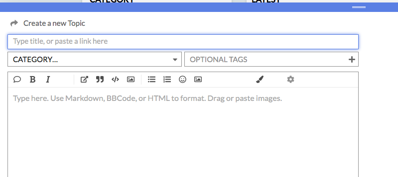

I used the Formatting toolbar plugin and the Daemonite Material Theme - #44 by pmusaraj and here’s what I see:
Make sure that:
  1. Your Discourse install is on the latest
  2. You have the latest version of the the plugin
  3. The theme is updated.
If the issue still persists, it would be a lot easier if you can share a link to your site so that we can check and see what’s wrong.

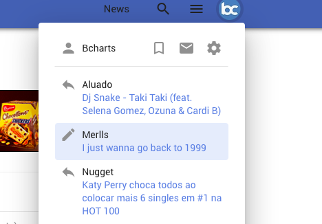

I was talking about how the last Discourse upgrade with FontAwesome 5 overridde Daemonite icon’s.
After last upgrade:
