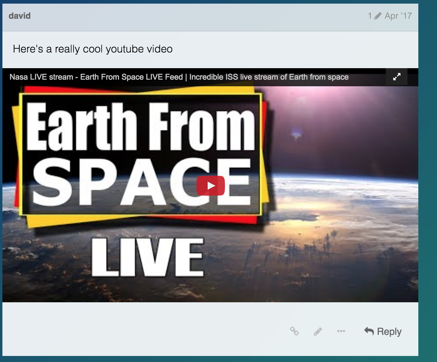

It works with any <iframe> or <video> (with some special treatment for lazyYT). It adds a button to every compatible thing, which then opens a little popup in the bottom right.
You can then “minimise” it, which keeps the audio going in the background, or completely close it.

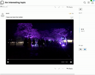

I have fixed this with the addition of an explicit z-index, and some explicit colours. With the vincent theme it now looks like this when you mouse-over:
You may want to add some further customisation to make it match your forum’s style :slight_smile:

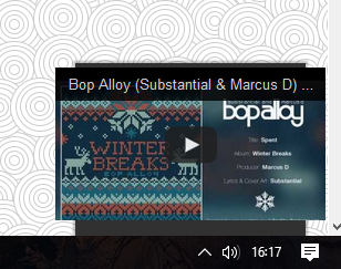

Just noticed this little :bug:

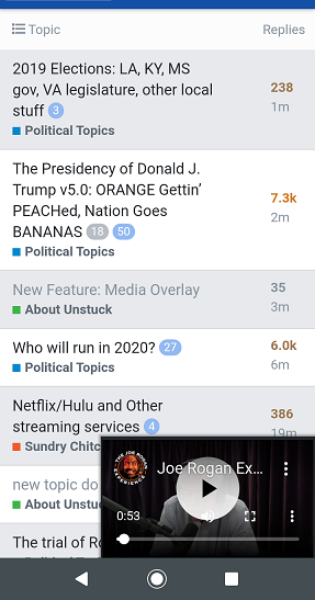

Вот как это выглядит на нашем форуме на моём телефоне с развёрнутым медиаплеером:
и свёрнутым:
Также видео не возобновляет воспроизведение при изменении его положения.
