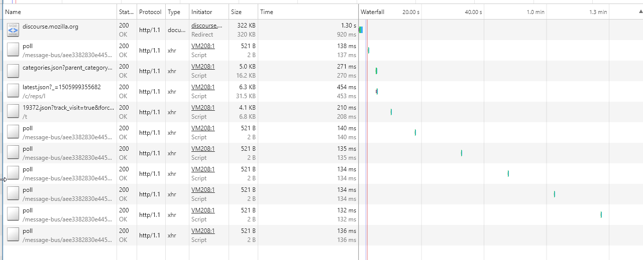

Noted your long polling events are completing almost immediately ~140ms

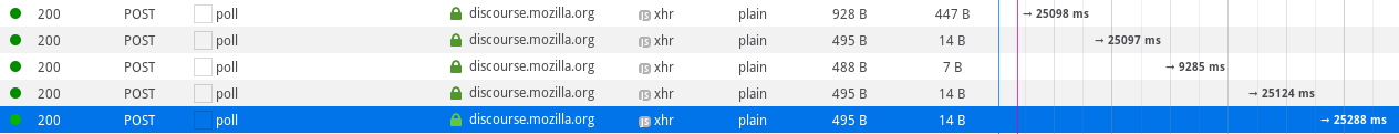

Compared with ~25s here at meta:

What’s the value of the site setting long polling base url?
Did you configure anything special in ELB and HAProxy regarding Message Bus / long polling?
Everything under /admin/site_settings/category/developer is set to default, apart from enable long polling. That was set to false back in 2016 (well before we started seeing this issue), so as expected enabling it didn’t make any difference.
So, long polling base url is the default of /.
No, we’re using the default configuration.
Bizarre… long polling interval is set to the default of 25000.
