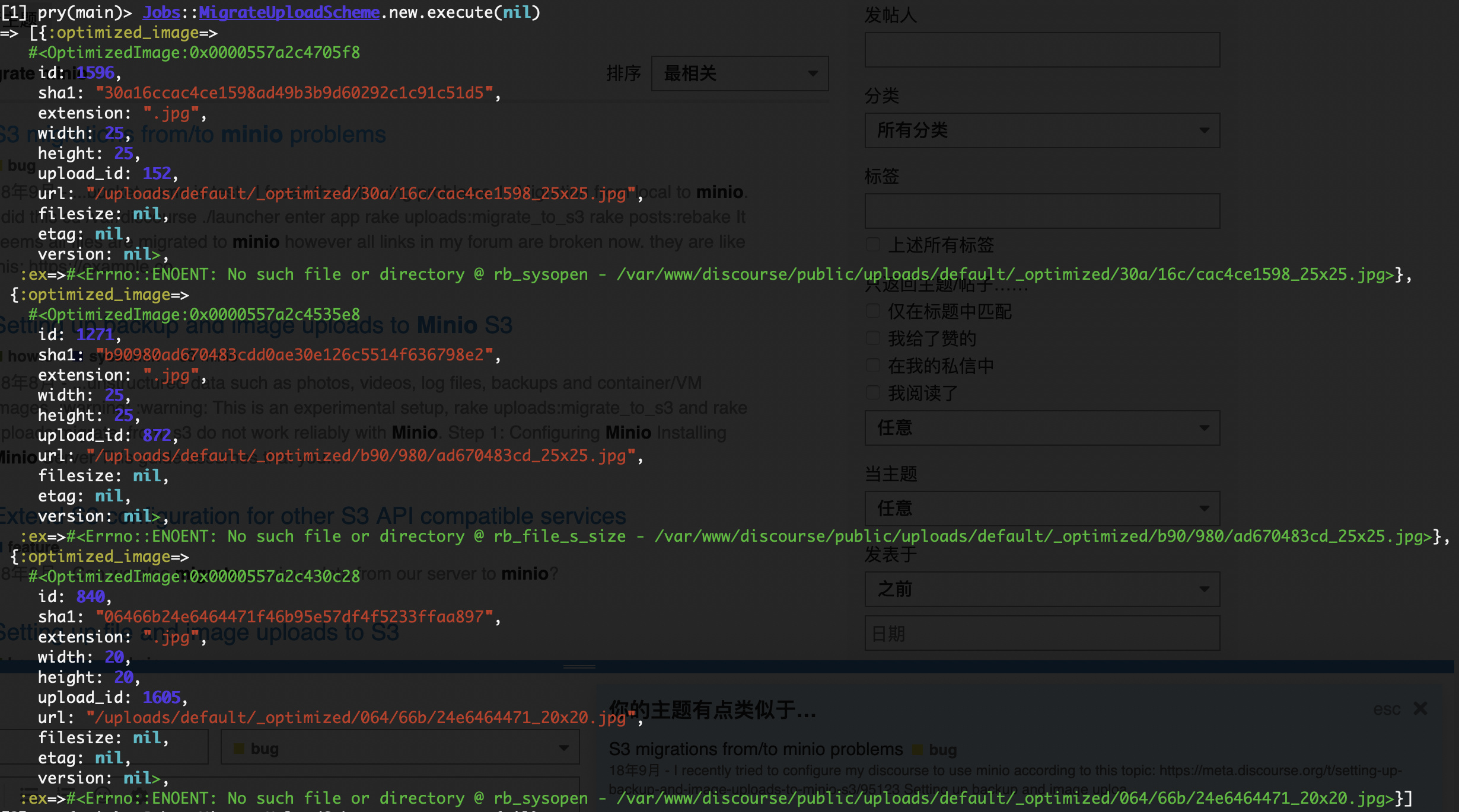

when I execute Jobs::MigrateUploadScheme.new.execute(nil) first time, it takes several hours and returned some exception, but seems finally success.
I execute it second time, it returns an empty array [].

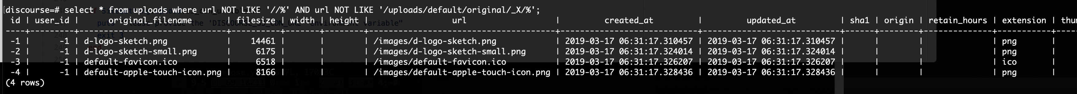

they’re site icons.

The problem that I think he was referring to is that migrate_to_s3 won’t run unless everything has been changed to the new scheme but the default/stock images are in the old scheme. And the process that updates them didn’t touch the stock images. (and if you run an update they get recreated)
