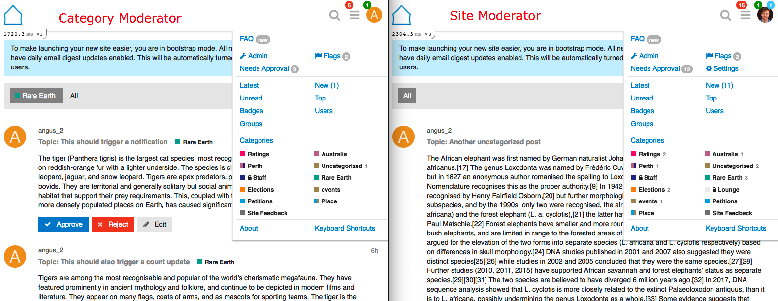

I’ve updated this plugin in the following ways:
  • There is now also a separate count and list for queued posts if a moderator is assigned to a category.
  • Moderators who are not assigned to a category are automatically added to a group site_moderators (if they are removed as mods or they become category mods, they are automatically removed). This makes it possible to target a message at non-category moderators
  • Category moderators are not sent the general PendingFlagsReminder and the PendingQueuedPostReminder (these are sent to site_moderators instead)

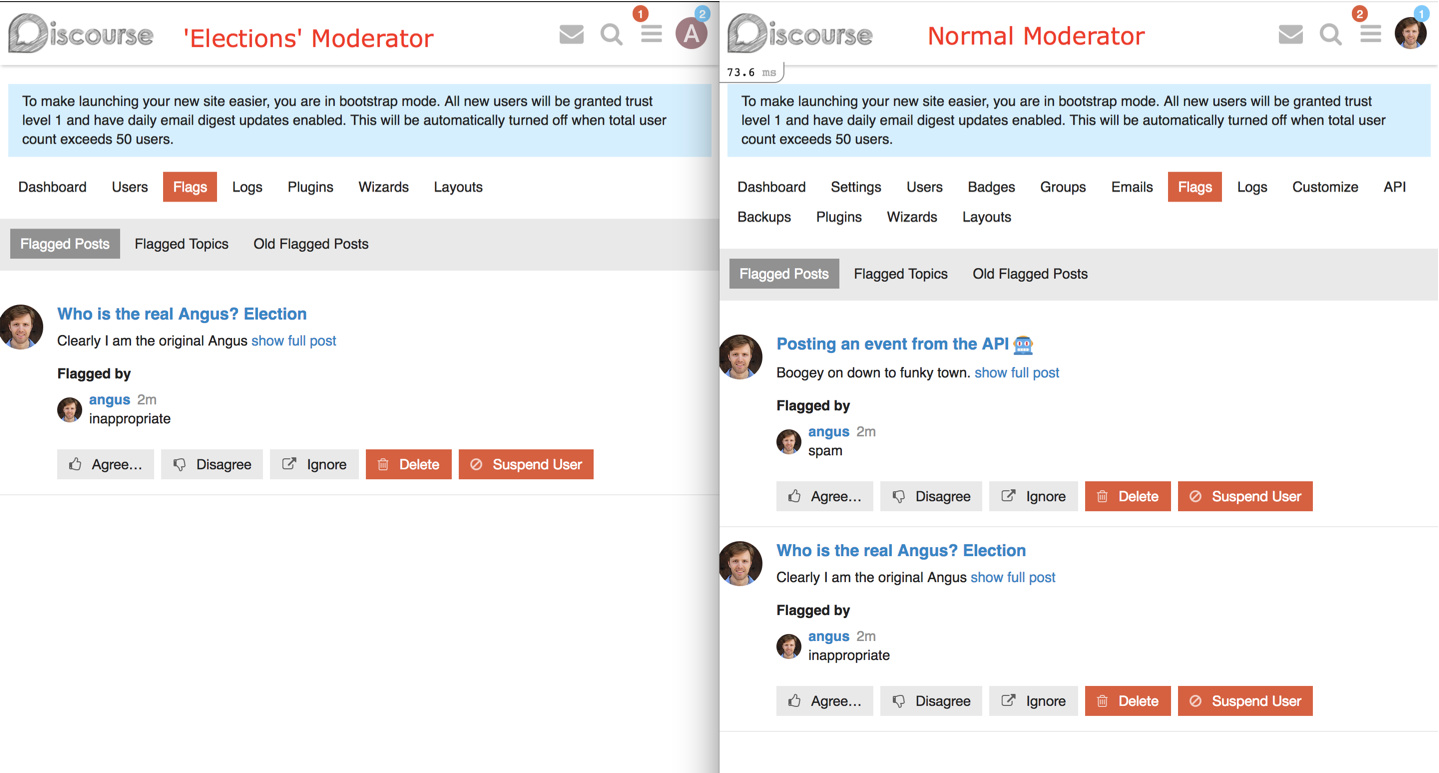

I’ve fixed the issue and tweaked the UX a bit too. There’s no separate category list now. A moderator assigned to a category just sees flagged posts and topics from their assigned category within the context of the normal flag lists.
(screenshot taken on my sandbox where plugin is live and working)

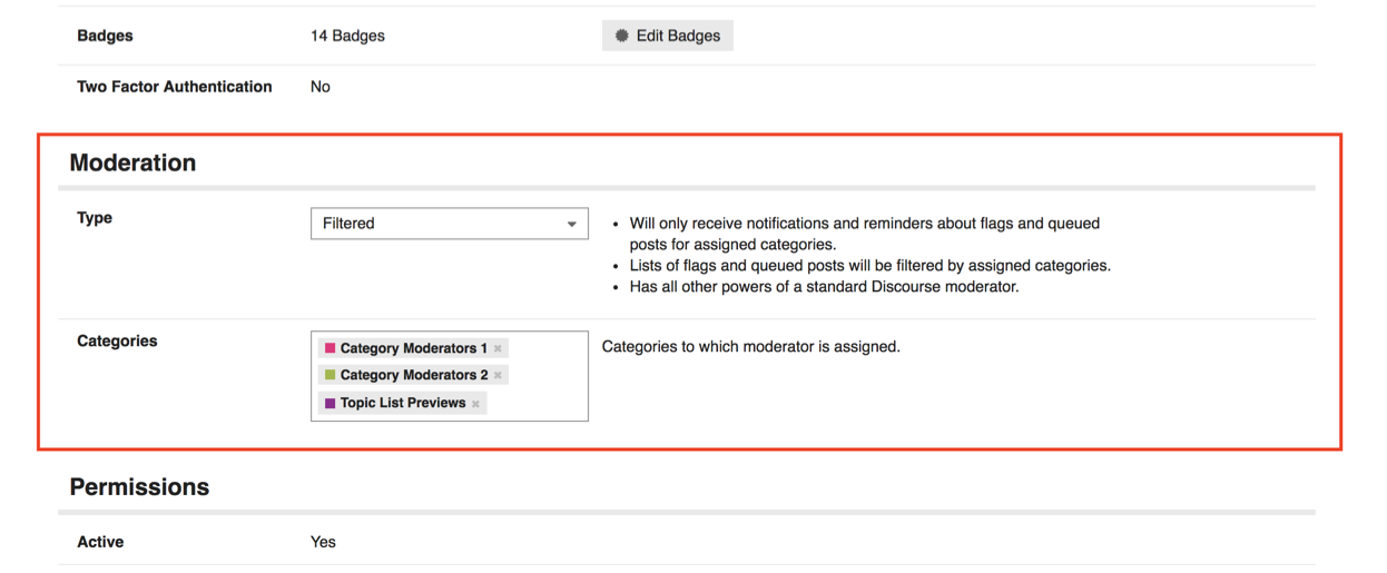

I did a deep dive on this plugin today and I’ve completely restructured it to make it more robust and extensible.
I haven’t entirely finished yet. I’ll follow up in the next day or so.
I’ve done a significant reworking of this plugin. I’ve changed it’s name to “Moderator Extension” to reflect a change of scope to include a variety of modifications to moderator functionality.
@hawk or @jomaxro could you update the topic title to “Moderator Extension”? Thanks.
https://github.com/angusmcleod/discourse-moderator-extension/commit/098adbba5159fe5ad47edc1ec0284a7768daaa42
The highlights of the changes are:
  • All moderator administration is now in /admin/users in a new “Moderation” section that appears if a user is a moderator. Like other settings in /admin/users, admins have read/write permissions and moderators have read permissions.
  • Moderators (currently) have two ‘types’: default and filtered. The key attributes of each of type is listed next to the ‘Type’ setting.
    • Default:
      • Standard Discourse moderator
    • Filtered:
      • Will only receive notifications and reminders about flags and queued posts for assigned categories.
      • Lists of flags and queued posts will be filtered by assigned categories.
      • Has all other powers of a standard Discourse moderator.
  • Moderators can now be assigned to multiple categories using the ‘Categories’ setting (see above screenshot). The significance of assignment to a category depends on the moderator type (see above descriptions).
  • When category assignments are filtering a moderator action list, like the flag lists, the filtering categories are listed.
  • As the description of the types states, all flag and queued post notifications and the reminder messages will reflect the moderator’s category assignments. This was true in the previous version, however this logic has been significantly upgraded to handle assignments to multiple categories.
  • You can now display a list of moderators assigned to a category above the topic list(s) for that category. There are both site-wide and category-specific settings for this.

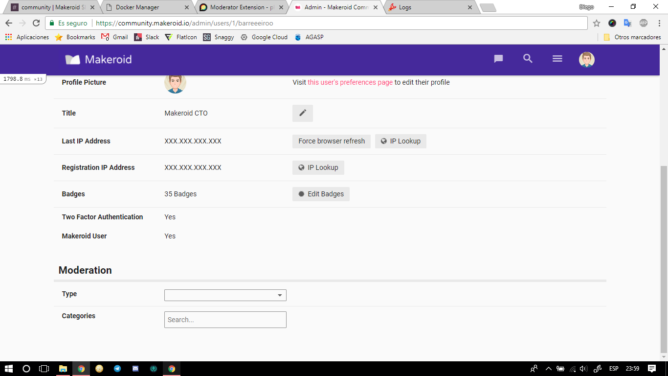

I think this plugin is broken
“IP Lookup” button doesn’t work, same as dropdown
With safe mode it was working
I’ve disabled it and waiting for Discourse to compile, but logs pointed to this plugin
Confirmed: I removed the plugin and now works
It seems like the plugin breaks the admin profile of moderators
Thanks for the bug report. This is now fixed.
https://github.com/angusmcleod/discourse-moderator-extension/commit/def9540af76be1db89a130fcdc2d240f3df406e5
