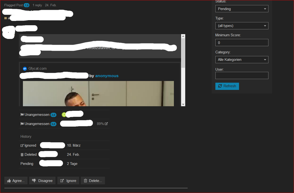

This is how is look like for an admin like myself.
And the moderator do not see this at all.

Hi @yanokwa is there any chance the flagged post is below your min score default visbility? I’m also wondering if perhaps the topic was deleted.
Aha if the flag existed before I fixed the old migration that explains it. A “Reviewable” is re-used if someone else flags the same thing. Viewing permissions are set on a “Reviewable” basis so those old ones that were migrated incorrectly will not show up for moderators if the content is flagged again.
