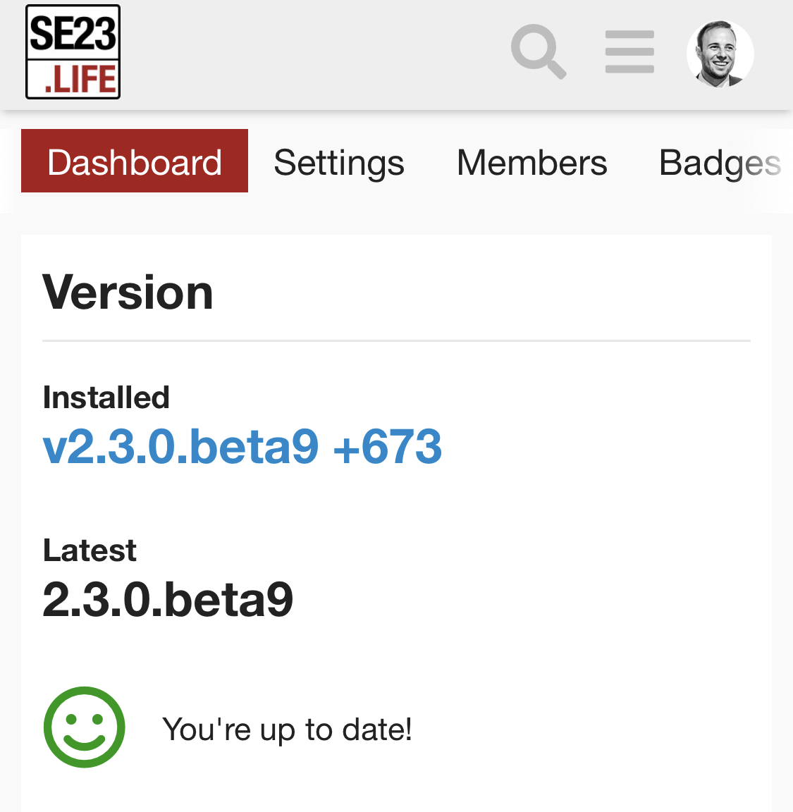

can you tell me exactly what commit your forum is on right now please ?
إعجابَين (2)
This is not latest, you don’t have:
https://github.com/discourse/discourse/commit/034502af2138aaf1e3a847ffcdc3f07ec83bbb6b
Sorry I wasn’t on my computer, maybe our CI was blocked on some test for a moment, and took time to get this commit in tests-passed. It’s definitely in now and should fix your issue.

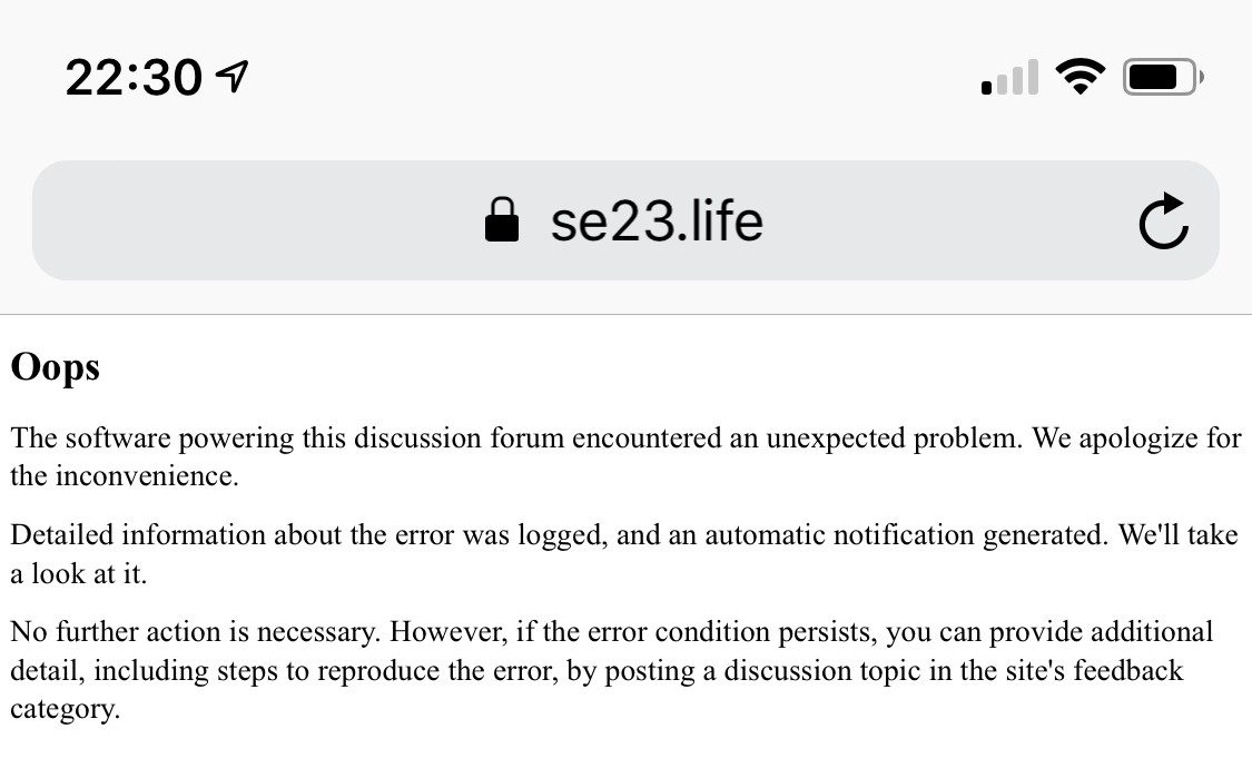

This is the error in production.log:
Started GET "/" for 82.44.224.199 at 2019-05-29 21:36:38 +0000
Processing by ListController#latest as HTML
Completed 500 Internal Server Error in 690ms (ActiveRecord: 0.0ms)
NoMethodError (undefined method `url' for nil:NilClass)

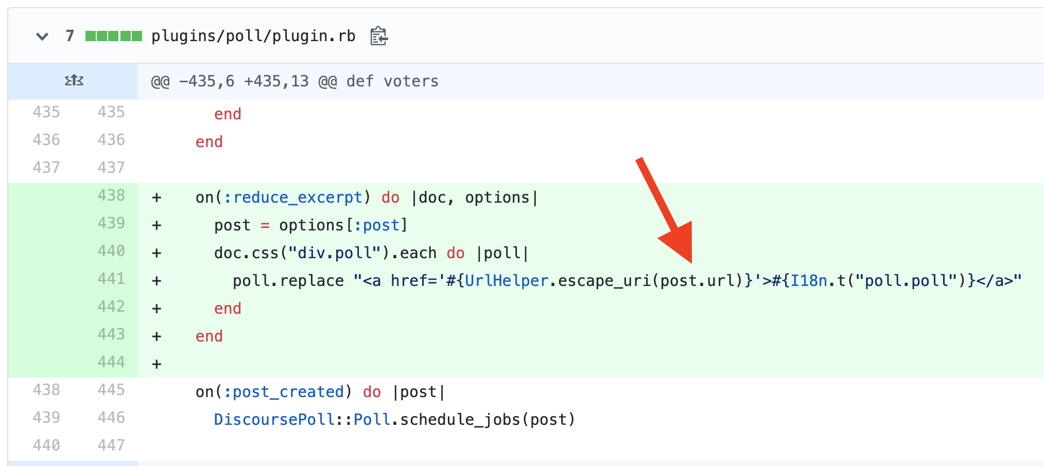

I notice the poll plugin has been recently changed. Any idea what might be wrong, @nbianca / @zogstrip ?
https://github.com/discourse/discourse/commit/227c45107df6b1d6aa43b624fe59995bcb2db73d#diff-170edb1ef99339086c2d8d1c2b264e90

Update this didn’t help. Forum still dead… ideas please anyone?! :sob:

Sorry about that. Can you try again once FIX: reduce poll when post is nil · discourse/discourse@a188d15 · GitHub gets on the test-passed branch?

In particular, here:
