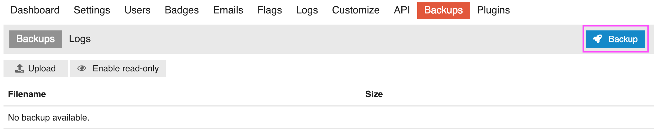

  1. Navigate to /admin/backups on your source Discourse instance.
  2. Click the Backup button to create a backup:
  3. When prompted, confirm by clicking Yes.
  4. Once the backup is complete, go to the Backup files tab, and locate the newly created backup.
  5. Click Download to receive an email with a download link. Click the link in the email to save the backup file locally.
