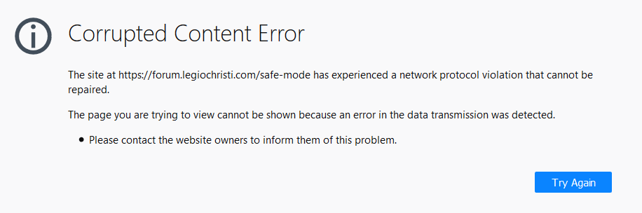

I’m getting this error when I try:
Chrome says it’s an invalid redirect.
Is there a way to do it through command line?
If there is, I’m not aware of it.
Perhaps someone more knowledgeable can comment on that. :sunflower:
