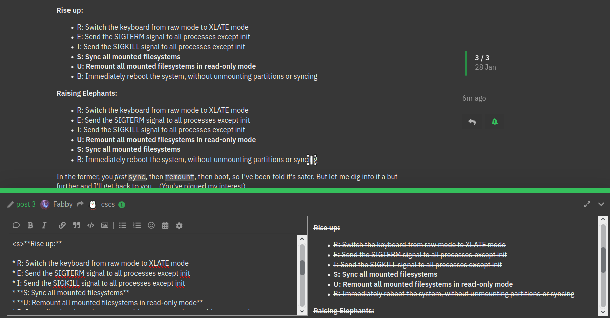

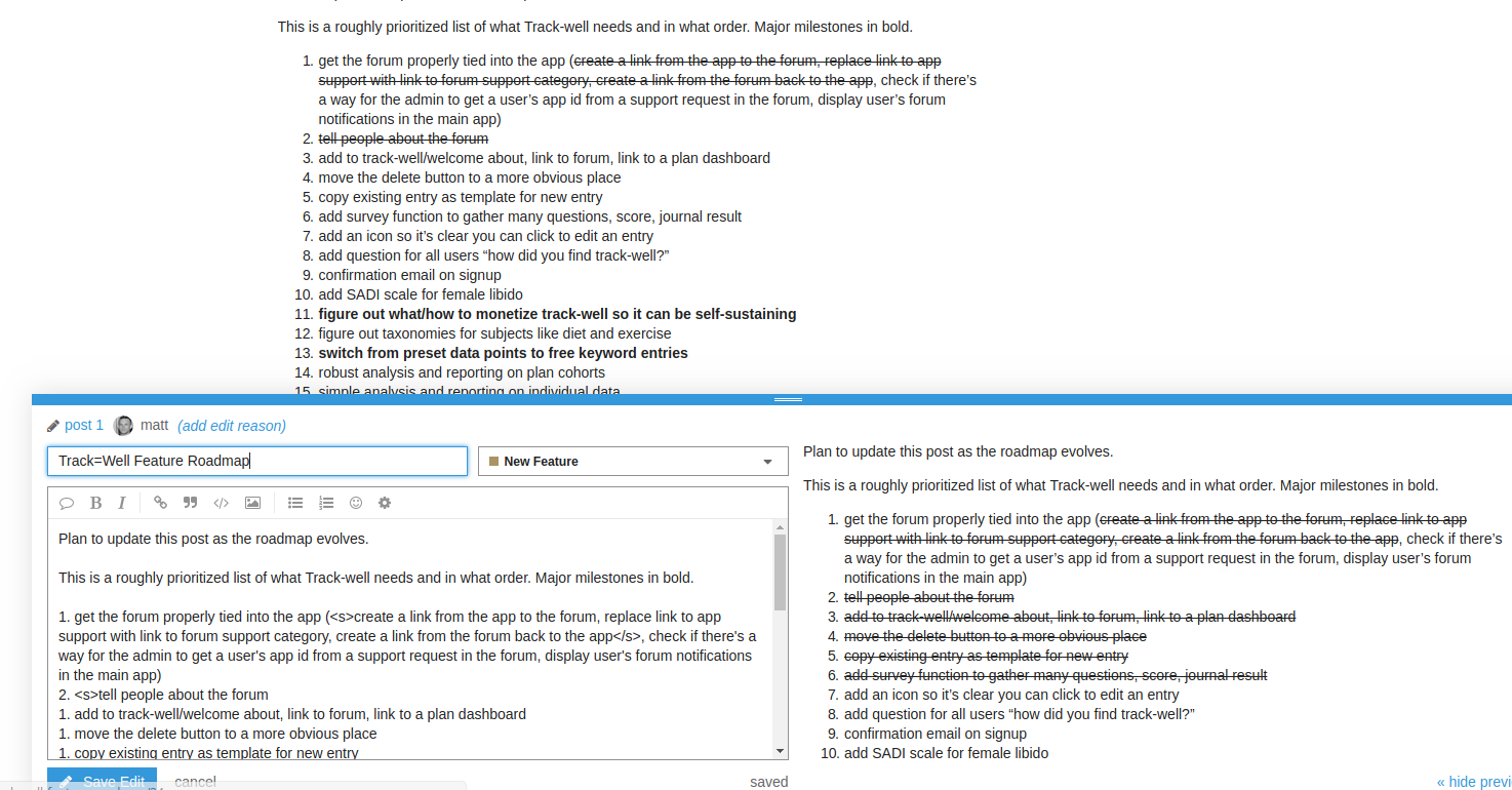

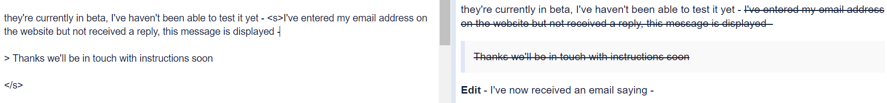

I’m not sure whether this bug is specific to Discourse but when I try to strikethrough several lines of text & one of those lines is a quote, the quote’s text is not struck out.
The preview displays the quoted text as struck out -
but when posted, it renders like this -

I’m still having the same issue in Markdown.it, in your example you haven’t got struck out text before the quote but in mine, I have -
looks like
