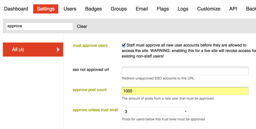

What site settings of mine would be relevant? I’ll post them here
Couldn’t hurt to take a look at any setting that has approve in it.
Here we go:

Here is repro on my hosted install:
  • Set must approve posts to 1000
  • As an admin, post a topic.
  • View that it needs approval
there’s a post trapped on my Consultants Discuss site now. I’ll delete it once this is confirmed.
