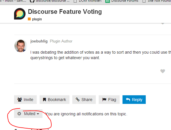

I just noticed on Meta a bug where muting a topic is still sending me notifications about the topic. Upon looking into this specific case, it’s even stranger.
Here’s the scenario:
  • I am “Watching” the plugin category. I started getting email notifications about this topic: Discourse Topic Voting
  • I don’t want to receive notifications on this topic, so I muted it.
  • I’m still receiving notifications :sadpanda:
  • Stranger still, I can’t see the topic listed on the plugin category page at https://meta.discourse.org/c/plugin/l/latest
What’s going on? :confused:

If a topic is muted it should be properly muted, going to check this out on local got it bookmarked.
It looks like it is muted correctly:

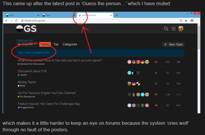

これは関連する問題ですか:個別にミュートされたトピックのウィンドウタブにカウントが表示されたままです。
完全な投稿:Muting Topics (and dismissing topics/posts see post 25) - #5 by Kosh - Meta - Online Go Forum
