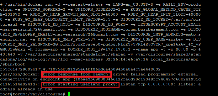

I just found error in rebuilding but don’t know how to solve it.
What is occupying the port 80 on your server?

cpradio
(cpradio)
21.Февраль.2018 11:07:16
7
Run this command, to identify what is taking up port 80 (and then provide us the output)
sudo lsof -t -i tcp:80 -s tcp:listen

Sorry, I copied and pasted it with an extra parameter, can you run it once more, using this (note: the missing -t argument)
sudo lsof -i tcp:80 -s tcp:listen
cpradio
(cpradio)
21.Февраль.2018 11:16:29
11
Perfect, so you have apache2 installed which is taking over port 80. Are you running other sites on this server (other than Discourse)?

cpradio
(cpradio)
21.Февраль.2018 11:22:42
13
okay, try running sudo apt-get remove apache2
If that doesn’t solve the issue, run dpkg -l | grep apache2 and remove each remaining component

cpradio
(cpradio)
21.Февраль.2018 11:26:31
16
Run the sudo lsof -i tcp:80 -s tcp:listen command again, is anything listening on port 80 anymore? From what I can tell, that is simply implying that apache2-bin apache2-data apache2-utils can be manually removed as well.
sudo apt-get remove apache2-bin apache2-data apache2-utils
The rc in front of apache2 means it was removed, but still has configuration files sitting on the system.

cpradio
(cpradio)
21.Февраль.2018 11:29:07
18
If discourse was already installed, a reboot should be sufficient for starting it back up, or you can run
cd /var/discourse
./launcher rebuild app

cpradio
(cpradio)
21.Февраль.2018 13:15:28
21
Anything taking up port 80 again? Are you sure it is the same error?
