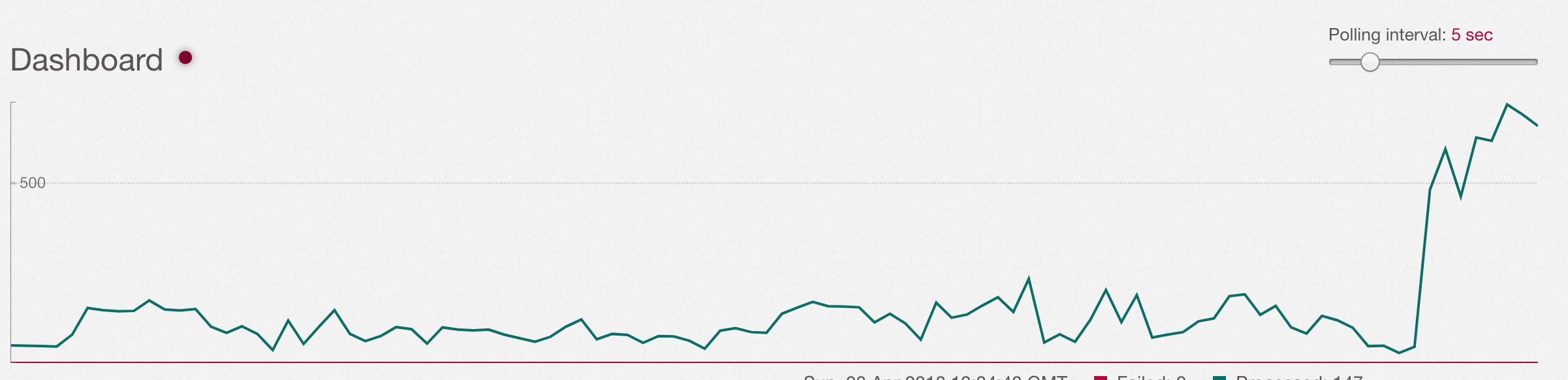

Now I’ve started my first large test, I noticed that the jobs processing has made several huge ‘steps’ in speed. I suspect this may have to do with a large number of my attached images having been moved to the tombstone - this is another ongoing project.
