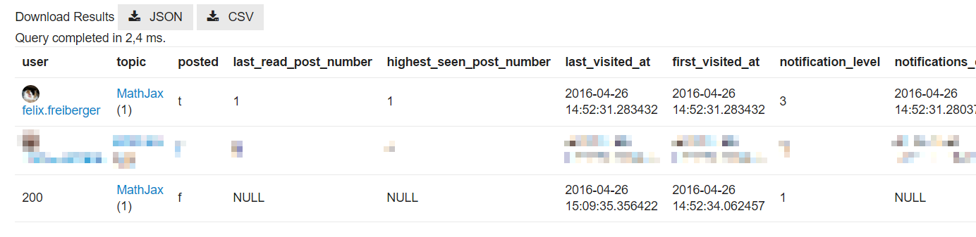

I’m running a Data Explorer query to see which users read a specific post:
-- [params]
-- integer :topic = 0
SELECT *, total_msecs_viewed / (1000 * 60) as mins_read
FROM topic_users
WHERE topic_id = :topic
ORDER BY total_msecs_viewed DESC
The results look plausible, except for a mysterious nonexisting user:
This is the result for topic 200. The user id 200 is not used in my installation (I have fewer users).
The same thing is happening for all other topics, there is always an entry for a “user” whose id matches the topic id.
Am I overlooking a very obvious bug in my SQL code? Is this entry really there? Should it be?

This returns 0 results, as expected.
So you know it’s a deleted account?
In that case you might want a more complex query that takes that into it.
No, the account never existed – I only have about 150 users, so the id has never been used.

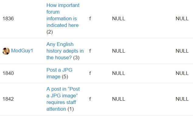

I tried to look at all entries where the user id equals the topic id:
SELECT *
FROM topic_users
WHERE user_id != topic_id
ORDER BY user_id
Even for low ids, the results look strange: Almost all have highest_seen_post_number = NULL, for example. In other rows in this table, this column almost always contains a plausible date.
I’m starting to believe that this is a #bug: It looks like something is inserting rows here and mistakes the topic id for the user id?

Anyway, I was also wrong about
Topic ids were actually being used as user ids, but because there were actual users with those id values it didn’t look obviously wrong at first.
The incorrect user ids are in the Postgres table and not a result of how Data Explorer works with the data
 user_id | topic_id | posted | last_read_post_number | highest_seen_post_number |
      56 |       56 | f      |                       |                          |
 last_visited_at       |      first_visited_at      | notification_level |
 2016-05-12 17:47:06.711945 | 2016-03-14 19:18:55.588447 |                  1 |
 notifications_changed_at | notifications_reason_id | total_msecs_viewed |
      |                         |                  0 |
 cleared_pinned_at | id  | last_emailed_post_number | liked | bookmarked
      | 434 |                          | f     | f
I don’t know how or why the topic ids could be getting used as user ids, but my feeling is it has to do with “no owner” posts. eg.
system = user id -1
“small actions”
anonymized accounts
I was alarmed when I saw that a March “post closed Flagged” message to FluffGuy1 with topic id 52
had RoyalGuy1 user id 52 as a topic_user.
But luckily RoyalGuy1 has no indication of it’s existence displayed anywhere, he is not included as a user in the message, and going to the URL gives “no permission”.
