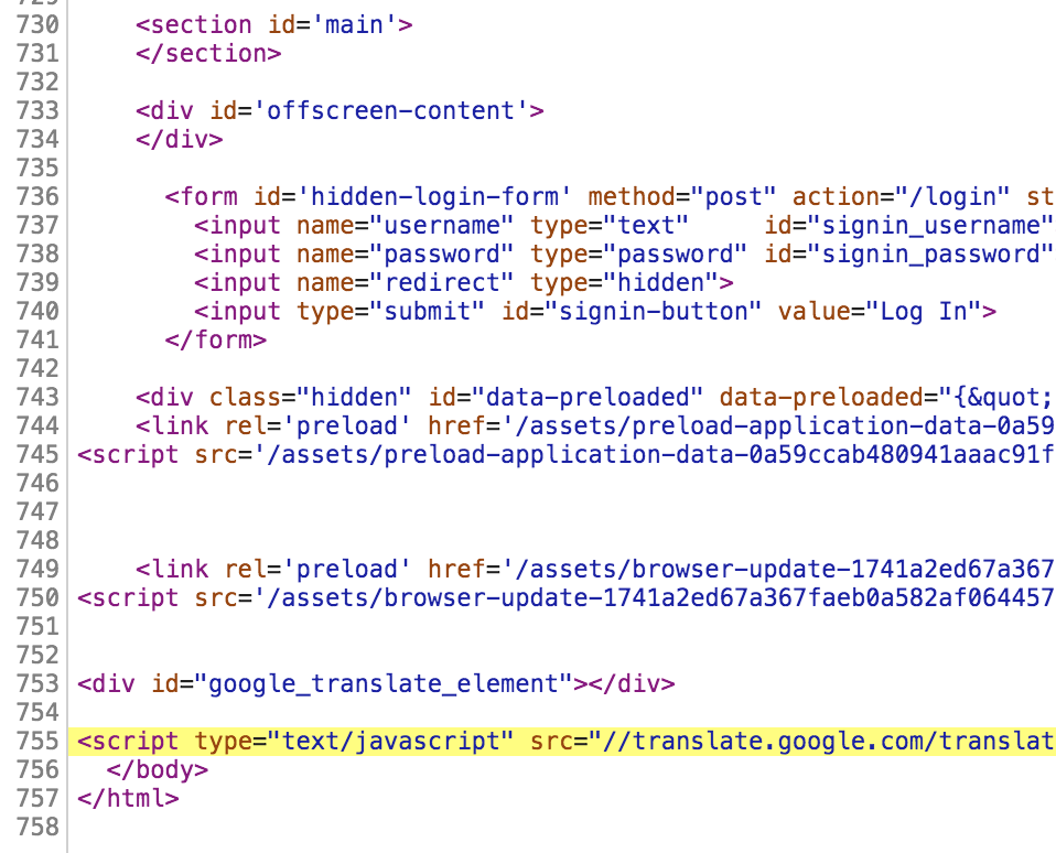

I found these two file in the original source that loads the google translate.
#sudo sed -i.bak ‘/server:before-body-close/d’ /var/www/discourse/app/views/layouts/application.html.erb &&
#sudo sed -i.bak ‘/server:before-body-close/d’ /var/www/discourse/app/views/layouts/no_ember.html.erb &&\
It is fine they want craw data from our site. But the visitor from China are suffering a huge delay because this one JS file. After I added these two line of code to app.yml, it still loaded google translate.

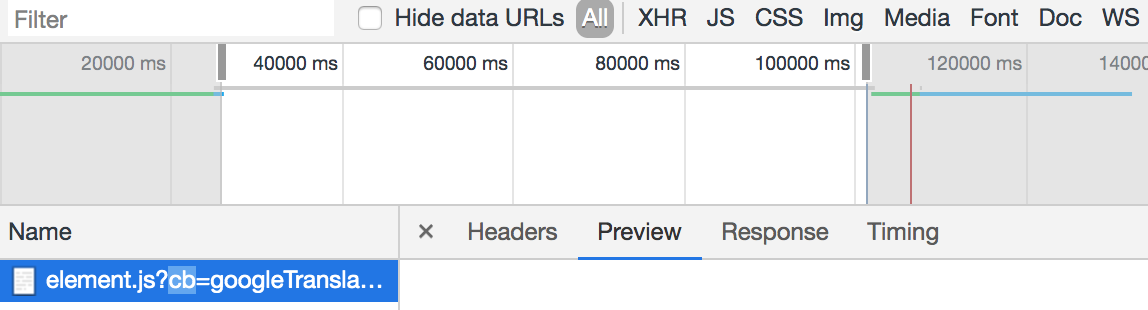

This is the thing I want to remove from the discourse.
That is coming from either a theme or a browser plugin. Can you share a link to this site?
One more thing makes me feel terrible. Even I recover from a backup file. Google is back as well.
https://bbs.sipeed.com
Absolutely it is not a browser plugin. Because everyone in China has the same problem.
That is a theme customization you added to your website.
If you disable themes using Safe Mode it goes away
Okay, I found that customization.. Thanks a lot!!!

This has nothing to do with docker at all.
Themes live in the database, so you should remove them the same way you added them, in the Admin UI.
So, in the end this was all coming from a change you site did on purpose and forgot about it?
