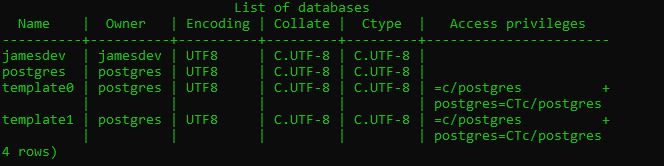

So I took a look at my dbs and this is what showed up. Looks like the access privileges are missing?
Also tried dropping db and creating it a couple times and same error persists.
Edit: Deleted the database and created it again and modified with access privileges and I can see that it is now granted access privileges but still no dice.
