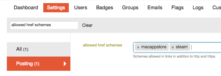

Support for more url schemes has been added! There’s a new setting called “allowed href schemes” where you can add a list of schemes to allow in links.

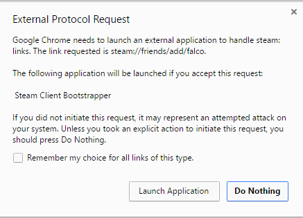

Me? Chrome 53, Windows 10 Pro.
Both links popped up this dialog where I clicked Launch Application :

11
@jomaxro I had wrong links, try now!
jomaxro
(Joshua Rosenfeld)
24 Octubre, 2016 19:53
12
Add friend isn’t opening Steam at all now, Dota 2 link is working.
