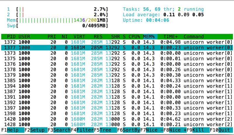

Hello, I have Discourse installed on DigitalOcean. I see the minimum requirements are 1 GB of RAM, although it seems my server is using more than expected. Any thoughts, is this normal? Thanks!
What about that screenshot do you consider to be abnormal?
Hi Matt, I don’t know if you had a chance to read the rest of what I wrote, but I read somewhere Discourse only requires 1 GB of RAM. If that’s the case, it seems my installation is using more than expected. I don’t have any users yet. Before restarting the server, some of the swap memory was being used as well. Perhaps I didn’t know Discourse needed so much memory, and that was my question: are these normal results? Most of the allotted memory is being used. Thanks!
Check the existing topic below
Yes, that’s normal.
What you can do is tune down the unicorn workers number. In one instance I have:
  • 280MB per unicorn worker
  • 200MB sidekiq
  • 180MB unicorn master
I guess going from 4 workers to 2 can shave you some memory.
PS: I’m assuming that you are running a ghost town, when you get more users revisit this.
