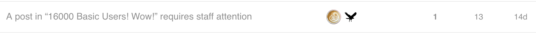

Here’s an example from two weeks ago when I filed the issue, I flagged a post and can see the flag in my sent items, I can also see that @Hawk responded to that sent item from /u/stephen/messages/sent:
But the reply never arrived in my inbox, that topic doesn’t exist in /u/stephen/messages at all.

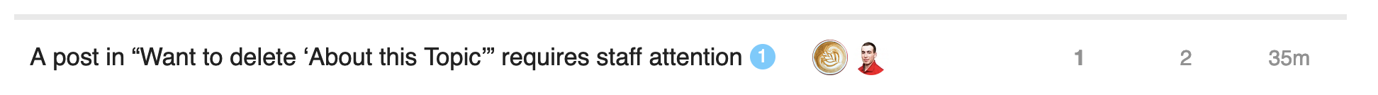

This just happened again, I reported something 30 minutes ago, noticed it had been acted upon but had received no notification.
Checking my inbox there’s no reply, but in my sent items I see the report with a reply from @jomaxro , still unread:
