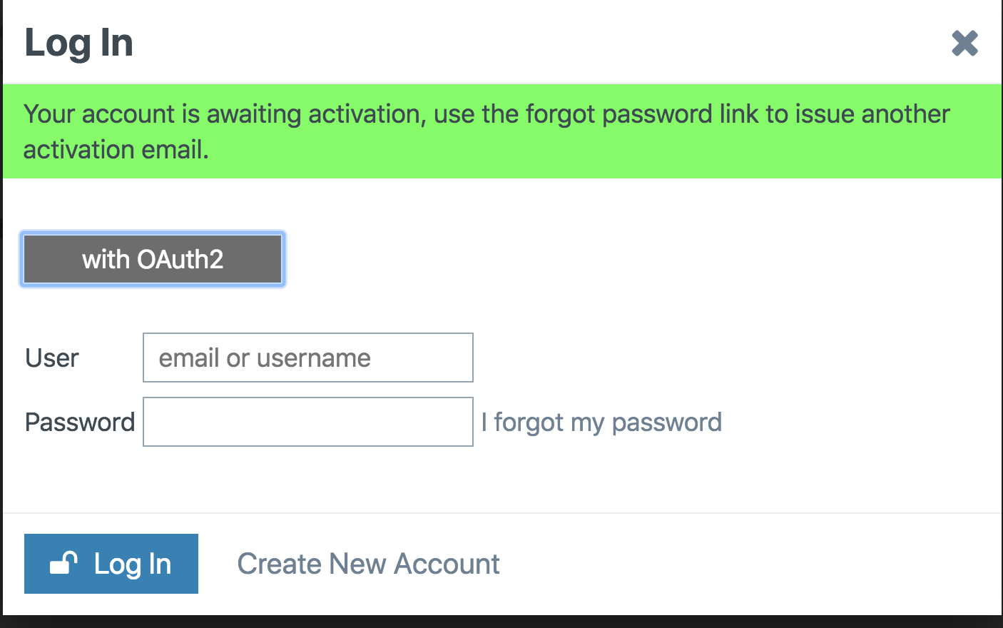

The issue I have now is the “requirement to verify email” before discourse creates the user record and logs the user in. Is there no way to turn this feature off via the dashboard config?
What is the best approach to work around this if the feature cant be turned off? I dont want the user to have to verify the email in discourse.

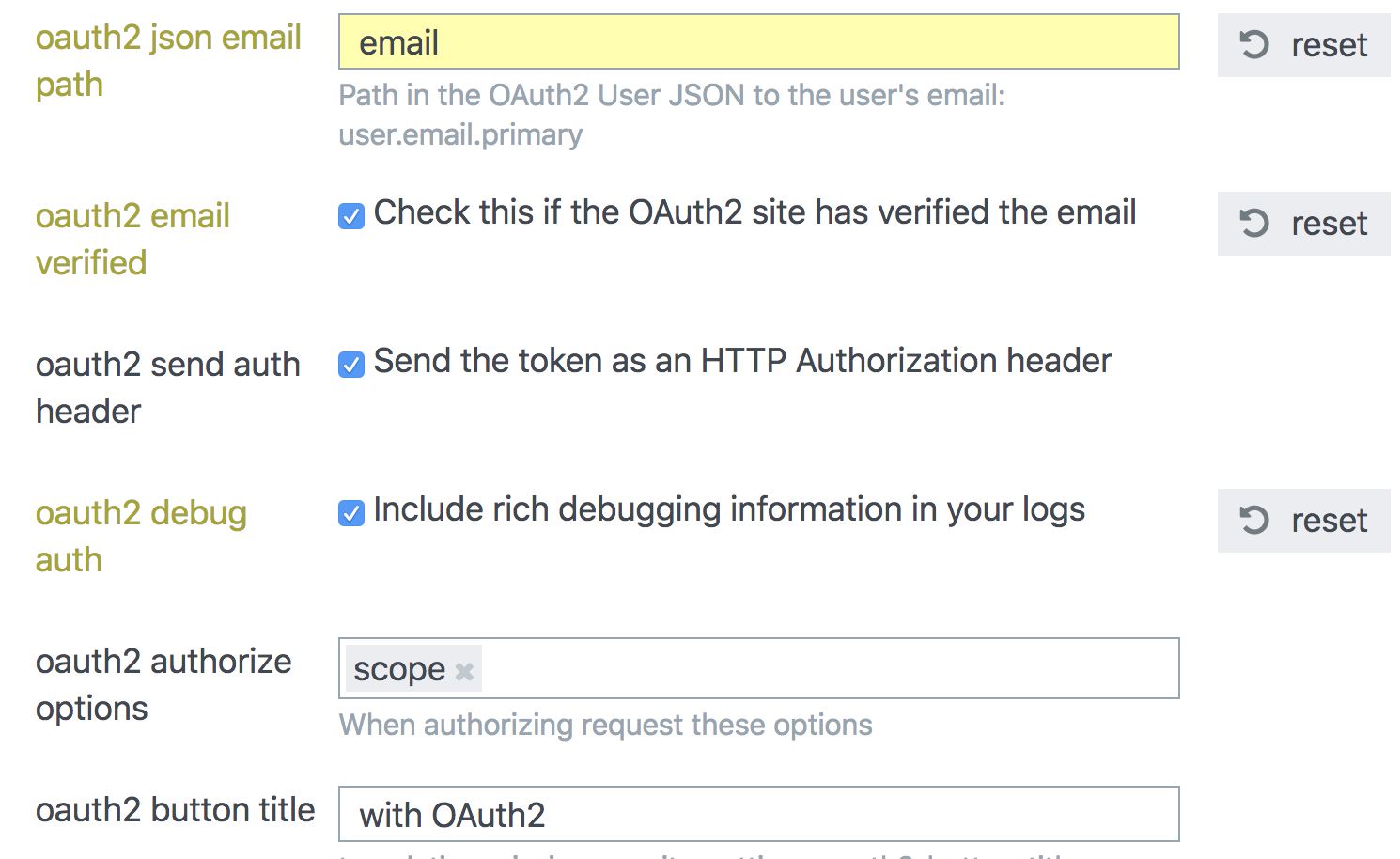

There is a setting called “oauth2 email verified” that you can check. Here is the description for the setting:
Check this if the OAuth2 site has verified the email
hi blake,
thanks for that. I did actually switch that on, but still get the message on the login page about email being unverified?
What do you have set in the “oauth2 json email path” box?
Maybe that isn’t set correctly
