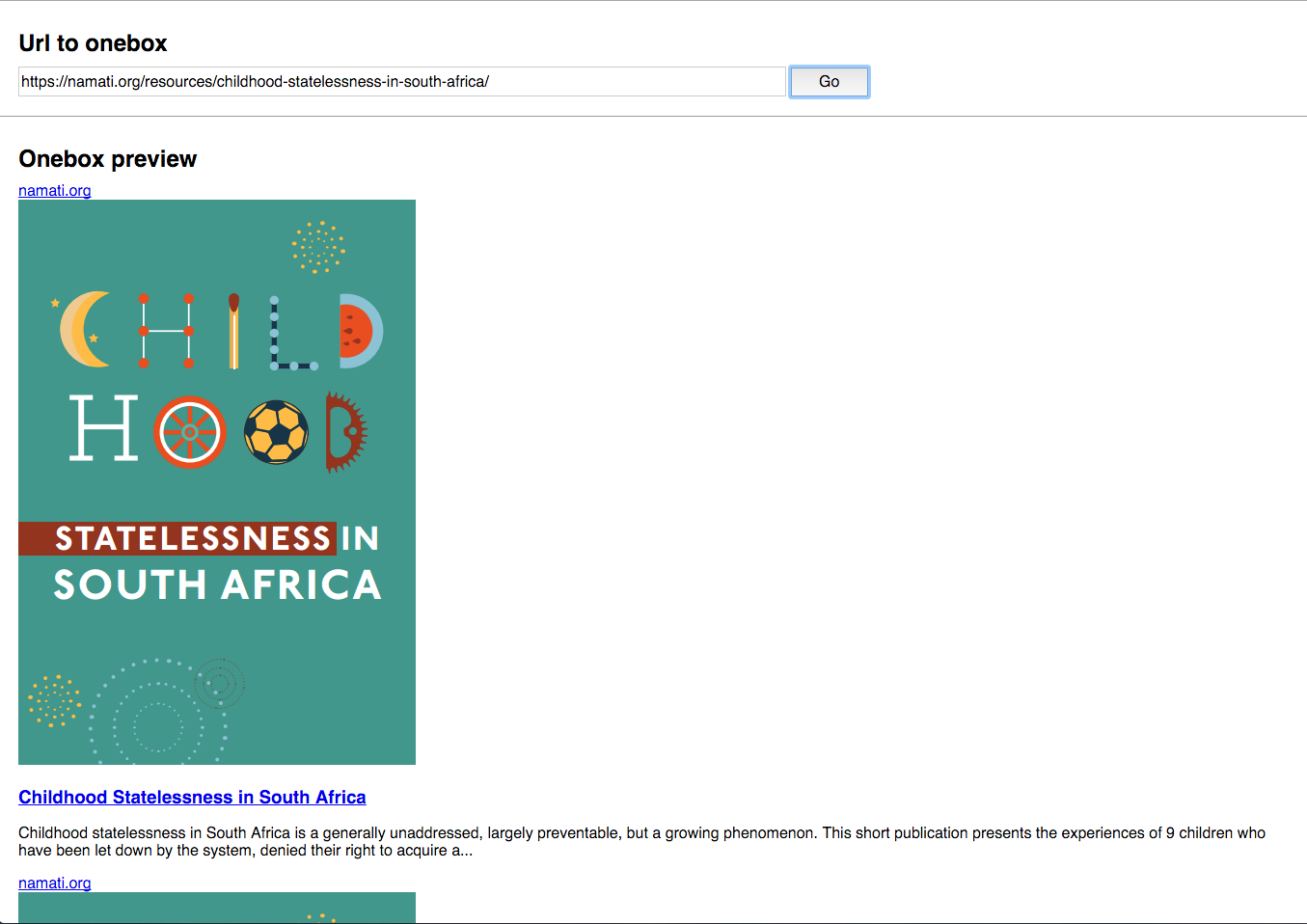

That site seems to be returning nothing for our custom user agent Discourse Forum Onebox vXXX
If I use Ruby like the onebox does outside of Discourse the onebox works fine.
So this must be the result of our new user agent string.
