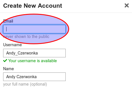

Well we got past the error, simply by regenerating the key. Looks like there a bug in the code, maybe it’s not being escaped properly, but it’s hard given there isn’t much to tell us that in the logs. There another issue though, it looks like the email is not being pulled across in the bootstrap process.

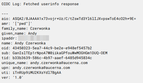

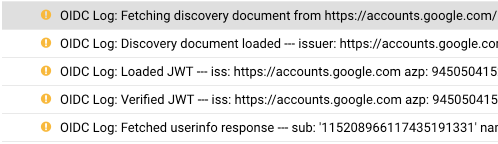

Enable the new openid connect verbose logging site setting, and you should see some useful information in your logs. For example:
The userinfo response line should show you whether the endpoint is returning an email address correctly
Fantastic! I’ll grabbed it and here is what I am seeing in the log as part of the userinfo response.
Also note, the discovery document shows
scopes_supported:
  - openid
So it looks like the userinfo endpoint does not include the email address. Maybe there is some configuration that can be done in Azure AD so that it provides the email?

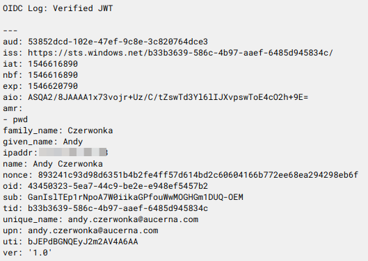

Is the email address included in the JWT?
Interestingly, we use the same configuration for other apps where Azure AD is the IDP and those applications seem to pull the email just fine. Admittedly, I don’t know all the details of those products and how they accomplish that.

Note that the e-mail address may not be returned in an email claim: in my case (once I got it working) it’s coming back in a name claim.
That is indeed what we’re seeing - so it sounds like AD does not quite comply with the openid-connect specification :cry:. If you can manage to configure AD to return it in the email claim, that would be the best solution. However, it looks like even microsoft’s own ruby implementation hacks around the problem:
You could try GitHub - discourse/discourse-azure-ad · GitHub instead (which uses GitHub - marknadig/omniauth-azure-oauth2 · GitHub under the covers)
If you really want to use the openid-connect plugin, you could write another plugin to ‘trick’ our openid-connect plugin into using the upn for the email address. Note that this would not be a ‘supported’ configuration, but if you have some ruby experience you could do something like this (not tested):
