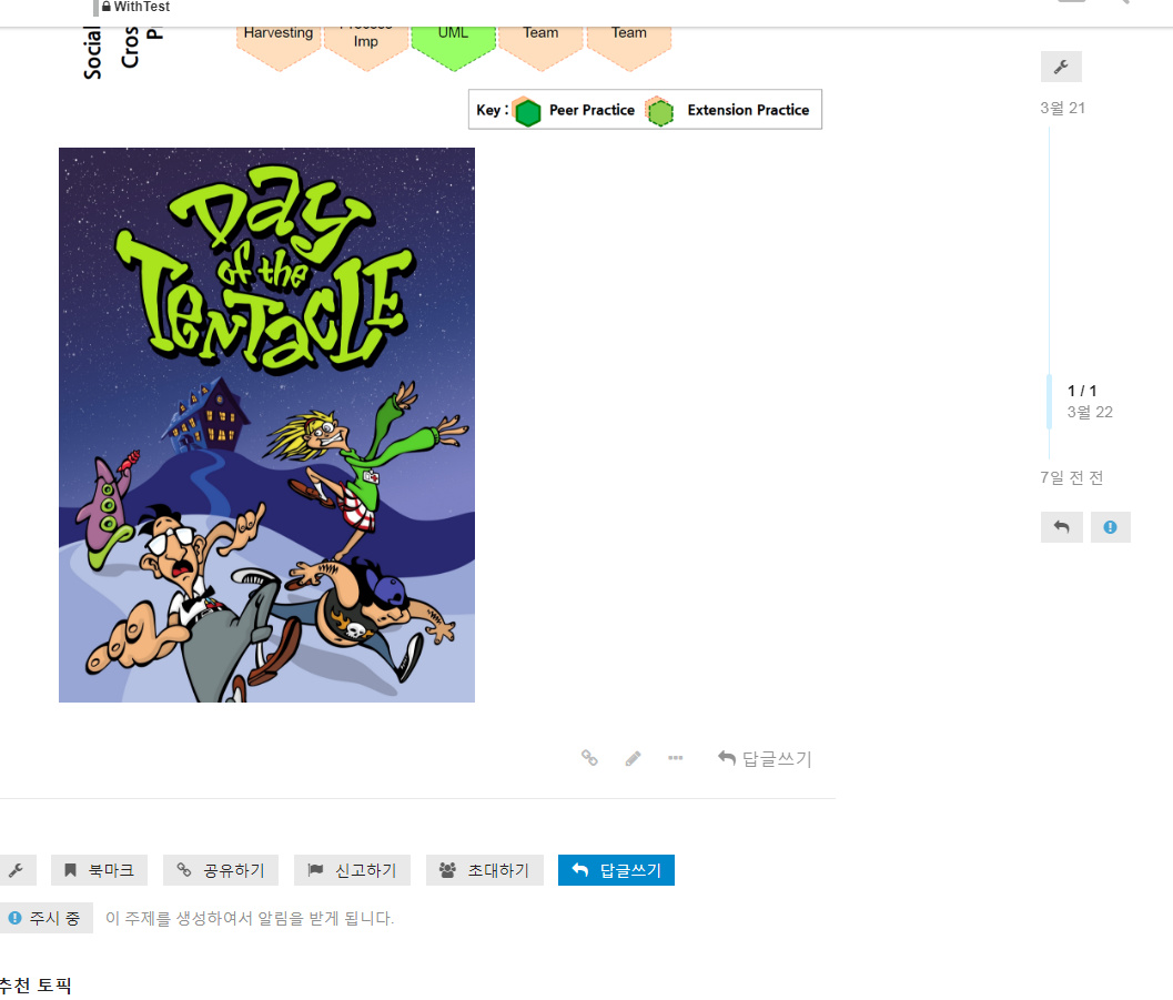

Could someone help me to get the image lightboxing working.
I uploaded a image. image resolution is 1772 x 2362.
But Images are without thumbnails and without lightboxes.
I checked create thumbnails option.
Settings part: File > create thumbnails
My Discourse is on private network. But we opened the firewall to connect from the outside.
Version is v2.0.0.beta5+12.
What is the problem?

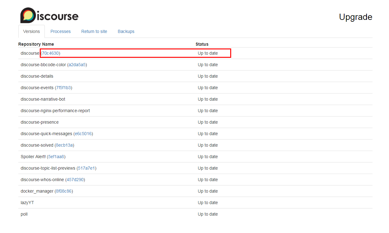

Thank you for your reply.
I updated today to latest revision and already up to date.
and I tried safe mode .
but lightbox is not appearing no matter how I get the picture/image into the Post.
What shoud I do??

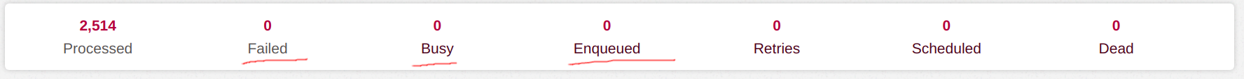

そのページに JavaScript エラーは見当たりません。Sidekiq に問題がないか確認していただけますか?
your.site.com/sidekiq
特に、以下のタブです
また、サイトの設定時に 公式ガイド に従ったことを確認していただけますか?
今のところ問題は見当たりません。
