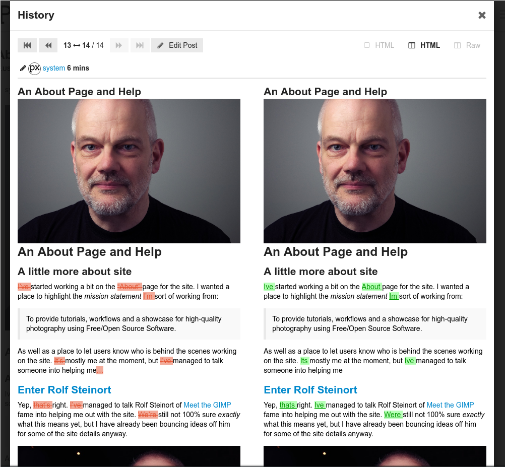

We’ve recently upgraded to 2.0.0.beta10~git49.9f422c93f6 and our latest RSS pull for comment embedding nuked apostrophes and quotes from the posts:

So this seems to be 2 separate issues:
  1. when upgrading from 2.0.0.beta9+git0 to the version mentioned above discourse decided it needs to refetch/rerender a lot of older posts from the RSS feed. This is how we noticed the 2nd bug
  2. It seems we lost at least all typography markers. also in our recent posts. The import category can be seen here PIXLS.US - discuss.pixls.us
It smells a bit like “RSS feed despite being sent with the correct headers is not seen/read as utf-8 encoded string so that the reencoding with the replace option strips utf-8 encoded chars.”
Thanks for bringing this to our notice. I have reverted the UTF-8 encode related changes I pushed few days ago.
Updating to latest version will normalize the behaviour.
Since the content was updated/changed the topic got updated as per this code. Now that I reverted the code, the topic will be updated again with proper formatting.
ok I patched out the “not recently polled” check for a moment. triggered the sidekig job and all our posts are good again.
