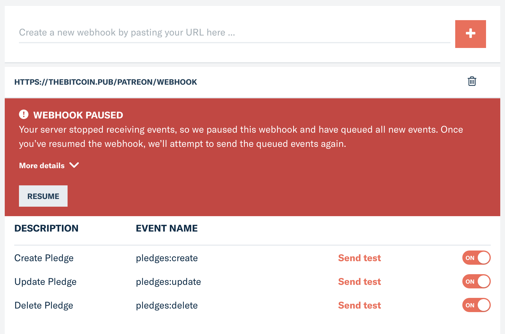

those webhooks though… always failing!
Update your Patreon plugin and try again. It have new fix to this problem.
