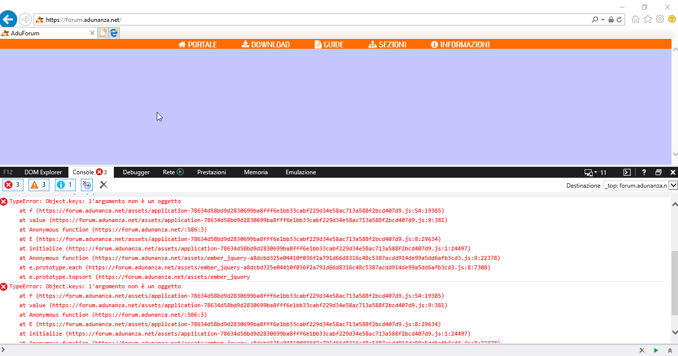

Привет @angus, я обнаружил, что мой форум не загружается в Internet Explorer (работает в Firefox, Chrome, Opera и Edge).
После множества перестроек (Discourse Signatures - #35) я выяснил, что проблема, похоже, связана с этой темой.
Когда я отключаю её в моей основной теме, форум загружается нормально.
Может ли кто-то, кто использует эту тему, проверить, загружается ли их сайт в IE, пожалуйста?
IE still doesn’t support Object.keys? Ok I’m downloading a few IE vms to do some more thorough testing…
@Trash @bombledmonk Fixed for IE 11 :sunny:

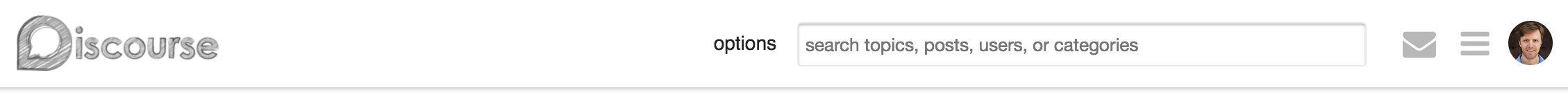

A little late, but here’s the css if you want the search bar to appear on the right of the header instead of the left. Add it in Admin > Customize.

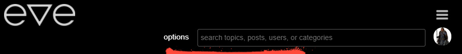

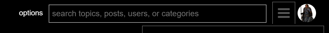

If you have the header search bar up and slowly shrink the width of the browser, there will come a point where the hamburger menu is moved above the user avatar if the search bar is aligned right:
and the hamburger menu and user avatar is moved slightly down if the bar is in it’s default position:
The theme automatically hides the search bar when the header becomes too small to contain it + the logo + the right icons. I had to increase the absolute width of the search bar to properly handle right alignment which threw that calculation off. The search bar should now disappear and the search icon re-appear in that scenario.
https://github.com/angusmcleod/discourse-header-search-theme/commit/22409b3eeb0c05473f688e42e4fc30ef2b59efab

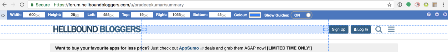

I’ve tweaked the size calculation logic here so that you can arbitrarily set the width of the header-search using css and the show hide behaviour will respond accordingly. This helps those with wide site logos.
The default width of the search-header contains, which holds both the search input and the contextual search options, is 600px.
This was an issue for sites with wide logos, as there wasn’t enough space to fit the element comfortably (particularly with the sign up / login buttons on the right).
Now you can add something like this to your custom css.
div.search-header {
    width: 400px;
And that new size will be factored into the calculation that determines whether to show / hide the search input when the window is resized.
https://github.com/angusmcleod/discourse-header-search-theme/commit/80b7d8ea8975c3eac26f8c6fa01fbe744a2c5b4a

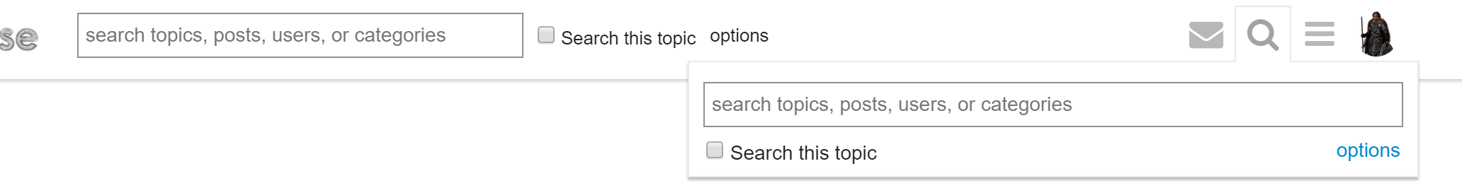

When in a topic, scrolling down until the search icon appears, clicking it and scrolling back up will make it so that there are two search bars on the screen at the same time. (Some times there’s a delay before the header search bar appears)
I think I did that part of that intentionally, the idea being that if you have one search open already, it would be jarring to have the search input suddenly jump to the header if you happened to scroll up. But it seems to be working imperfectly. I’ll take a look tomorrow.
