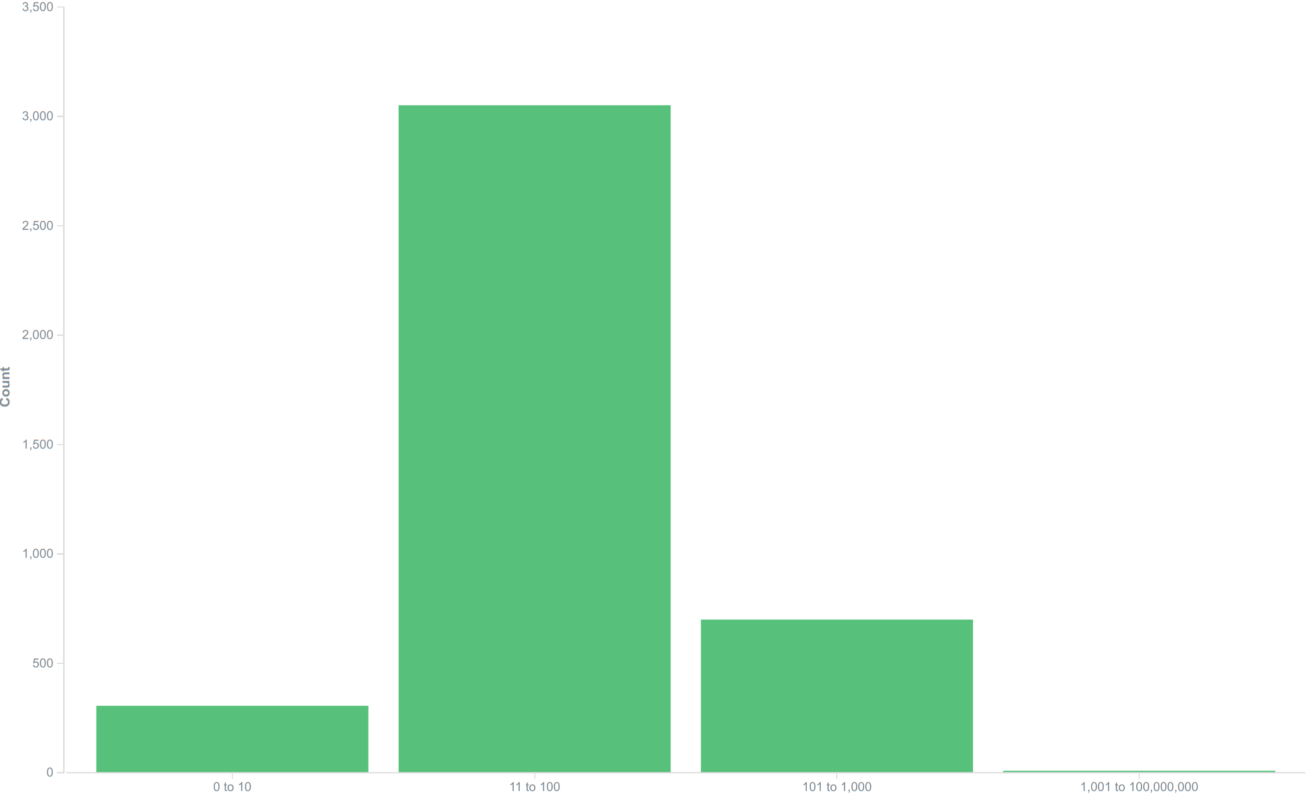

Number of posts made is about the least interesting metric, even more so over such a long time period. Page views is far, far more relevant for determining needed resources. It can be a bit tricky to compare the requests and traffic patterns of a “traditional” mostly-server-generated forum to a Discourse forum, because Discourse is very API-driven, so we often serve multiple HTTP hits per “page view”, but we tend to service each HTTP request a lot quicker, so the forum appears to be a lot more responsive to the user, as shown by this breakdown of just dynamically-generated response times:
Most page-generation-oriented “traditional” forums would, for the same level of user behaviour, probably have a lower volume of requests, but they’d be pushed a lot further to the right; it’s rare for a traditional forum to be generating a majority of responses in under 100 milliseconds.
I’m not putting up that graph to brag about how good Discourse is (although it is rather impressive, IMBO), but rather to highlight that the way you think about provisioning capacity for a Discourse site can be a little different to how you’d figure out how many, say, php-fpm workers to keep in stock.

It’s topics/show and topics/posts where we start to get to into what would normally be considered “page views”, and even then, performance is pretty solid, with the majority of responses being made in under 100ms, as shown by this graph of the aggregate of response times for topics/show and topics/posts:
(I split the 100-1000 group in half, just to show we weren’t cheating with a lot of nearly-one-second responses or anything)
