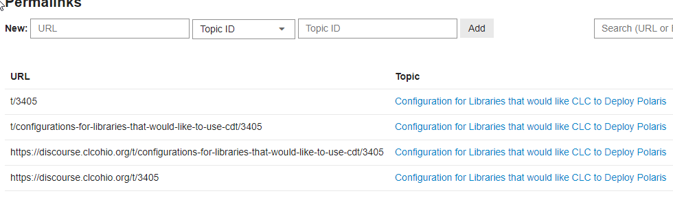

I would like to redirect topic 3405 to topic 5618. So anyone linking to 3405 gets sent to topic 5618, instead.
I read up on Permalinks here:
https://meta.discourse.org/t/59727
https://meta.discourse.org/t/88918
I tried setting it up a few ways:
But none of these seem to make topic 3405 redirect to topic 5618.
I don’t believe it’s possible to redirect a topic to another topic with a permalink. You’d end up with a topic that exists but is inaccessible (because visiting it redirects you).
What you could do instead is close the original topic and make the last reply a link to the new one. Or if you want to hide the original topic entirely you could archive it.

Wait a second this should technically work if you delete topic 3405 and access old link as a non-admin.
Improved the UI to include description via:
