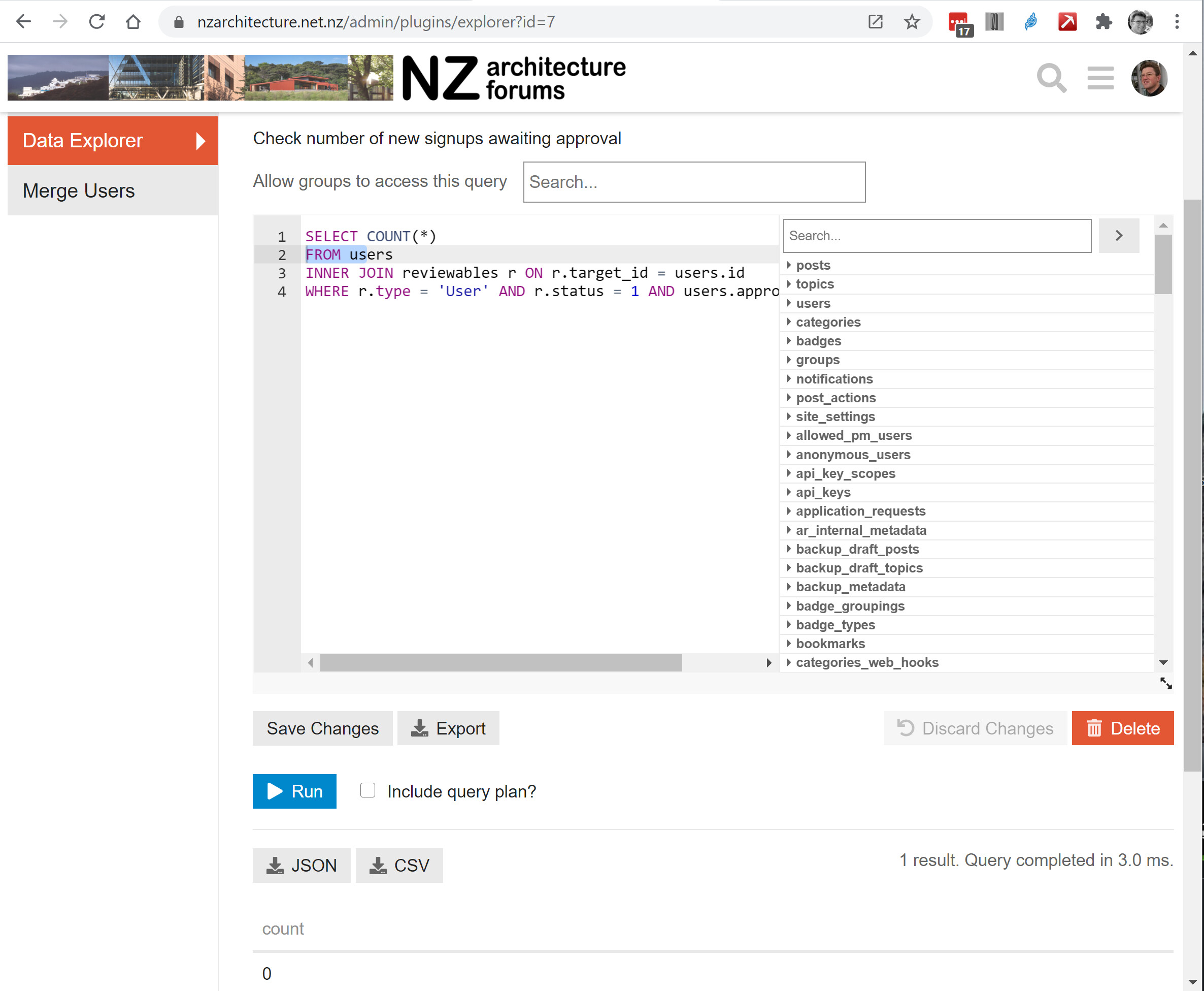

Can you run this query on the data explorer to confirm that this is the case?
SELECT COUNT(*)
FROM users
INNER JOIN reviewables r ON r.target_id = users.id
WHERE r.type = 'User' AND r.status = 1 AND users.approved = FALSE
Hi Roman.
I just ran it, and assuming I did it properly (see screenshot), the count was zero

Sorry, I realized that the WHERE clause is wrong. It should be r.type = 'ReviewableUser' instead of User.
Can you run this one instead?

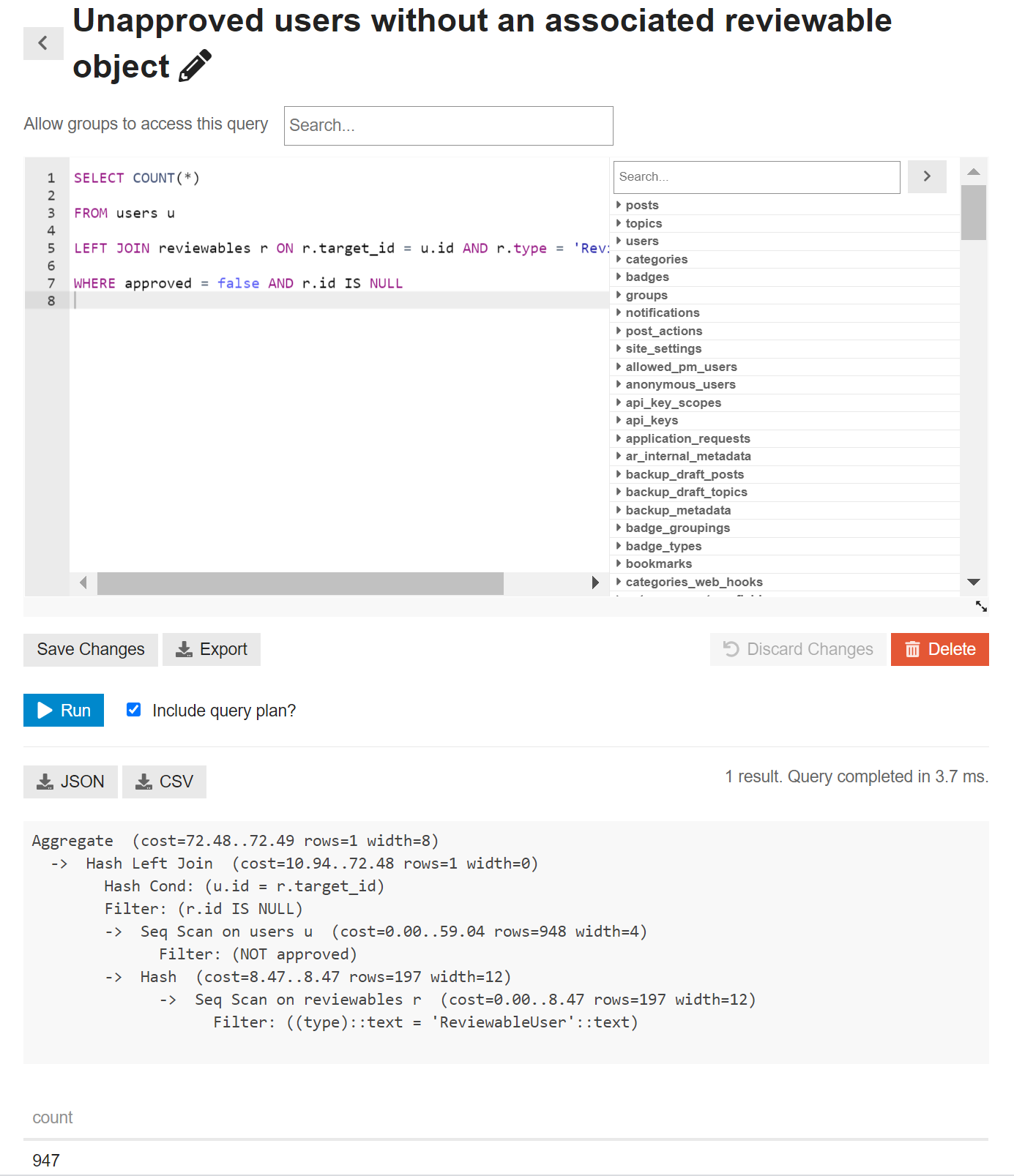

Hey @Paul_King,
Would you mind checking if your site has any unapproved users without an associated reviewable object? I’ve been trying to reproduce this bug without luck so far.
Here’s a query to do so:
SELECT COUNT(*)
FROM users u
LEFT JOIN reviewables r ON r.target_id = u.id AND r.type = 'ReviewableUser'
WHERE approved = false AND r.id IS NULL
also, try:
SELECT COUNT(*) FROM users WHERE approved = false AND active = true
Hi thanks Roman
Here is result of first query:
Not sure if relevant, but there are a lot of posts that were imported from a defunct yahoo group that is the precursor to current forum - merged in for continuity and searchability reasons. The creators of those old posts (dating back to early 2000’s) often won’t have accounts on the current forum.
