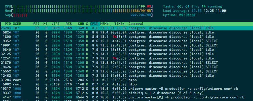

Hi there, I’m seeing an issue on my docker install. It’s on Linode on Ubuntu 14.04.
Postgres is using 100% of the CPU. The forum itself is working just fine, version v1.6.0.beta7 +156. Doesn’t seem any slower or anything.
Here’s a screen capture from “htop”:
Any pointers on how I can diagnose this and remedy it?

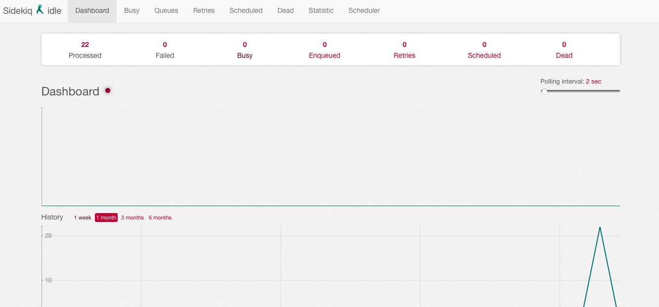

Are there any jobs running?
Try opening the following URL for your site:
/sidekiq
Doesn’t look like anything else is running.
Ok, there is one job in the “scheduler” tab that is running.
Jobs::EnsureDbConsistency 41 minutes ago RUNNING -1ms _scheduler_localhost-app:29119:1:29c83b7cc82551f6a2b801e82a1acb38
Should I just wait that out? Seems like it’s checking the database?

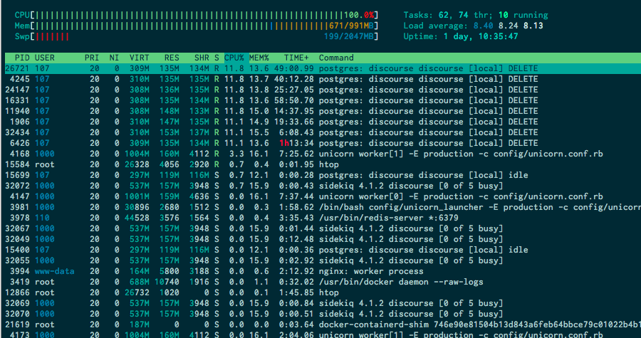

Do they start every x minutes or something like that? I currently have 5 of them running … Up from 3 a few hours ago.
Well, this morning we’re up to a load average of 12 :slight_smile:
But it does appear to have moved on from the “DELETE” queries, and is running others. I assume this is some sort of database check.
The forum is still responsive with this load, so I’ll let it proceed for a while. Seems a bit crazy though.

Anyway, it eventually got up to 16 instances of that query running, so I just killed them off. They haven’t returned in a few hours. I’ll check if it starts using CPU when that scheduled task starts again.
So it was running fine for most of yesterday after I killed the processes. This morning they’re back, with 8 of those queries running, and a load average of 8.

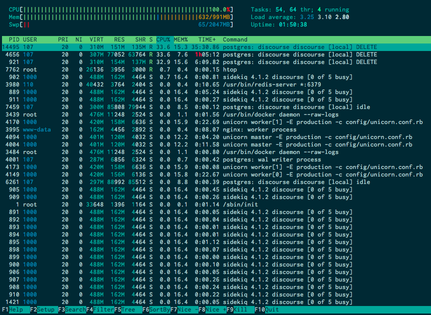

So I’m getting the exact same problem again, 2 years later :slight_smile:
It’s still getting stuck on the EnsureDbConsistency task, and spawning new ones until the server load is very high.
All of the connections are the same as before,
